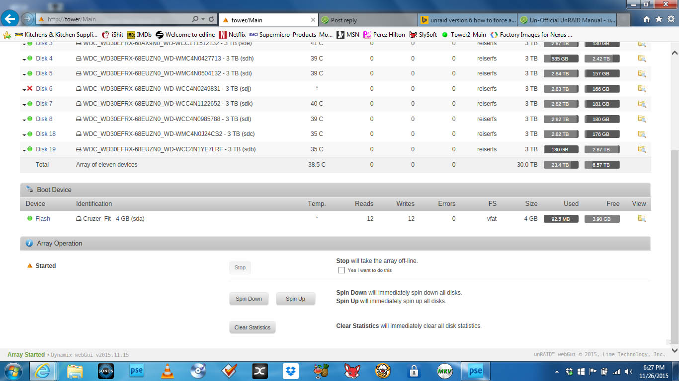

I cranked down the screw in my controller card that serves several drives.  One disk became disabled from this mistake I made.  I took the card out, cleaned it and re-inserted it.  Now all is working well.  The card can see the drive but it is disabled.  I can choose the drive from the dropdown list but it stays disabled.
I tried the remove drive, start array, powerdown array, reinstall drive and power up array to get it to rebuild, but no go.  The drive shows, but with the dreaded red 'x' and "device is disabled, contents emulated.
Do I reformat the drive in a windows machine and reformat in raid and rebuild?  I have a backup of it's contents in Windows format.  I know the data is still good on the drive, it's just that I messed with the cabling much too much.

Stop The array, change that disk to be not installed.  Start the array, stop the array.  Change that disk to be the appropriate disk.  Start the array and it will be rebuilding onto the disk.
Got it.  I left out a step.  It's now rebuilding.  Thanks.

I still have the red x but my bubble notes that pop up say array is now good with 0 disk errors.
Smart report for that disk says 0 errors.
It still says drive is being emulated.  Is there a way to force a partiy check (like in version 5).  Would that work by having it correct any errors there are?

It didn't rebuild properly.  Probably the disk dropped offline.  You should post your diagnostics
I just am NOT getting it.  I'm not seeing it.
What diagnostics would be best.  SMART report says disk is good.  No errors.  Why is my array still unprotected?
I have Array Devices, Boot Device, and Array Operations.  I have started, array unprotected.  In version 5 there was a 'parity check' section.  In this version there is not.
With a disk disabled, there is nothing for parity to check while its emulating the contents of the disabled drive.
Assuming you followed the directions I posted a couple of messages above, the rebuild failed for some reason.  Go to Tools / Diagnostics and post the file.
Diagnostics file.
I see the write errors for disk 6 near the end of the sys log file.  Can't imagine disk is actually bad since this all started with me man-handing the controller card.

Disk 6 suffered a write error at the start of the rebuild (preceded by a cryptic error from the driver) hence why unraid disabled the drive again.  Smart does look good on that drive, so I would reseat the cabling to the drive, as some googling found that it *may* be the cause.
I had an almost identical error for the past few weeks. Ended up being a bad power connector. I had replaced the disk, sata cable and port. Drive came right back on after I replaced power. Rebuild on 5tb took 24 hours.
I tried a second rebuild.  Went on overnight.  All is back to normal!
Thank you for your help.  I now understand that if a disk is disabled, you can't run parity.  The disk must be rebuilt first.  Will mark this as solved.
