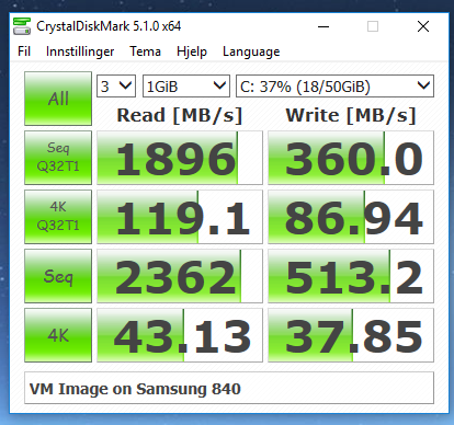

I benched it with AS SSD, but I'll give it a go with Crystal Disk Mark and report back with the results some time during the weekend.
If you want to to do any re-runs for different setting you might try, let me know

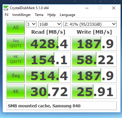

Here are the benchmarks for the system drive, which is a vdisk on the cache, and the mounted share where the steam library is, which is a cache-only share, mounted through SMB. Doesn't seem bad at all, so I guess AS SSD was the issue for me.
Weirdly the network speed seems more realistic similar to my test. and like i saw, the direct drive seems way way over the top.
It doesn't seem to be a speed issue but i wonder if there is additional latency to starting a read via the network which may cause the issue we are seeing.
