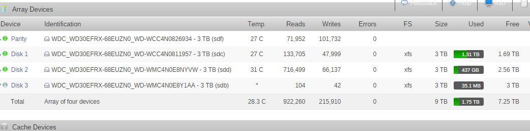

Sorry to be confusing.  I have added a screenshot to show you my build and that I do have a Parity.
As you can see Drive 3 isn't being used but it is part of the Array.

Your array looks fine. If you haven't recently, you might want to run a parity check to just confirm.
UnRaid allows you to add new drives, but the way data is stored and shared across the drives is under user control. Most people use user shares. You can review your user share settings to ensure files are being directed to the appropriate disks. Both allocation method and split level, in addition to included / excludes disks, come into play. I see no reason to attempt to rebalance data across the drives. Instead, if set properly, new files well start being stored on the new drives and eventually fill up to the same levels as other drives.
Look at the wiki on user shares. It is quite well documented with examples..
But to be clear, unRaid will not rebalance data when you add a new disk. If you saw this somewhere please post a reference do it can be corrected. The good news is this feature is not needed.
And with the default settings of high water for allocation method nothing will get stored to disk 3 until both 1 and 2 have less than 1.5tb free on them
