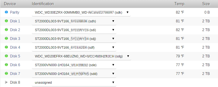

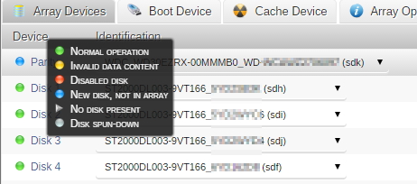

Today, I booted back up and it shows parity disk is a "new disk, not in array". Haven't started the array yet.
Any ideas on what I should do?

Powered off and checked the controller card and all sas/sata connections. Everything looks good.
Powered back on and I'm in the same state with the "New Parity" disk: "new disk, not in array"
Should I replace the Parity drive and start a sync again? Should I leave the old one in there and start a sync?

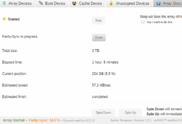

Appears to have stopped, but far short of completing.

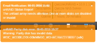

Also, nice little orange notification error...Parity disk has invalid data
And...the array apparently has stopped itself.

I've started the array again and again it starts a parity check, but the array stops a little while later.
Warning: Parity disk has invalid data
What should I do?

I'm starting to wonder if during the party-sync the system is rebooting. I just noticed that the system shows online for only 2+ hours.  I started the array/sync before then.
