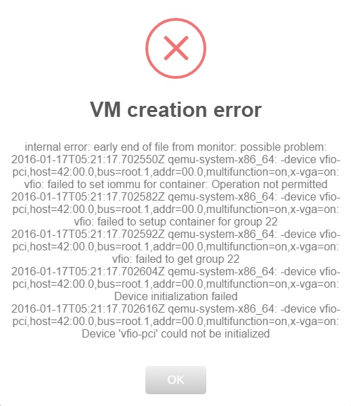

I received this error while trying to create a vm (see attachment)?
vfio: failed to set iommu for container: Operation not permitted
Odds on, you've got another device in the same IOMMU group as the video card you're trying to pass.  Turning on ACS override or trying a different PCIe slot may alleviate the problem

internal error: early end of file from monitor: possible problem:
2016-01-17T17:21:07.921012Z qemu-system-x86_64: -device vfio-pci,host=0f:00.0,bus=root.1,addr=00.0,multifunction=on,x-vga=on: vfio: failed to set iommu for container: Operation not permitted
2016-01-17T17:21:07.921043Z qemu-system-x86_64: -device vfio-pci,host=0f:00.0,bus=root.1,addr=00.0,multifunction=on,x-vga=on: vfio: failed to setup container for group 15
2016-01-17T17:21:07.921052Z qemu-system-x86_64: -device vfio-pci,host=0f:00.0,bus=root.1,addr=00.0,multifunction=on,x-vga=on: vfio: failed to get group 15
2016-01-17T17:21:07.921064Z qemu-system-x86_64: -device vfio-pci,host=0f:00.0,bus=root.1,addr=00.0,multifunction=on,x-vga=on: Device initialization failed
2016-01-17T17:21:07.921076Z qemu-system-x86_64: -device vfio-pci,host=0f:00.0,bus=root.1,addr=00.0,multifunction=on,x-vga=on: Device 'vfio-pci' could not be initialized

Edit your syslinux (main > flash > syslinux configuration).  A few lines under the line "menu default" you'll see the word "append".  Add a space after that word and type the following:
vfio_iommu_type1.allow_unsafe_interrupts=1
Apply the changes and reboot your system.  Report back if that works.
I think we are closer, at least it didn't fail on creation... error : qemuAgentSend:898 : Guest agent is not responding: Guest agent not available for now.  I've included the diagnostics (wish I would've seen this option earlier).  :)
tower-diagnostics-20160119-1917.zip
rebooted and looks better. we have passthru. thank you for your help.
