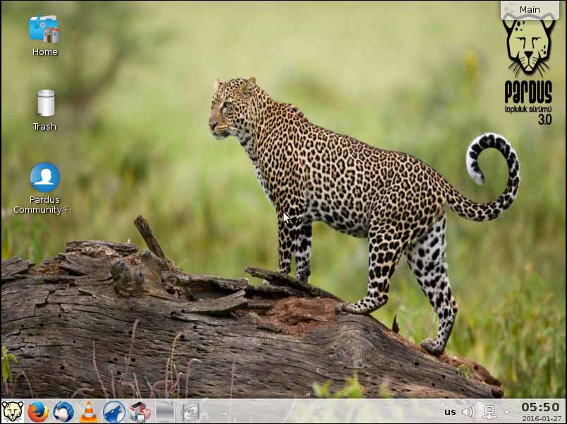

Okay, I downloaded and installed it ... and it's in Turkish !!  How can I switch the language to English??
Hehe, I'm just wondering if jonathan knew that all along...  ;D
:D Well, I knew it started in Turkish, but the version I used was from 2011, I haven't looked at the new versions. Apparently it's changed in the new(ish) release.
I still occasionally use the VM I have of the earlier version, and it was ahead of it's time when it came out for ease of use, look and feel, etc, for a linux distro.
http://www.linuxuser.co.uk/reviews/pardus-2013-review-the-mighty-have-fallen
Here is a link that has locations for the 2011 version, if you are interested.
http://distrowatch.com/?newsid=06471

Actually that link has the English distro for the current version as well ... killed the one I created in Turkish and re-installed in English ... works just fine  :)
