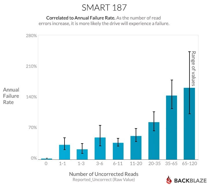

Ok! Here is the attributes for the disk that is showing me a orange triangle on the dashboard tab. Number 187 is highlighted in yellow.

187 Reported uncorrect 0x0032 089 089 000 Old age Always Never 11

According to blackblaze anything above 0 it’s not good news and there’s a much higher probability of failure in the near future, I’ve no personal experience with that attribute, and I’ve seen many here on the forum with higher values, since the disk is 3 yeas old and you don't know how long it's been like that I would monitor value for a few weeks and see it stays stable, also always good to have a spare handy.
Ok thanks.  Will do.  I usually do have a hot 3 pass preclear drive ready but 2 days ago decided to make it a cache drive as I had never previously used a cache.  I need to get another hot spare.  Thanks!
