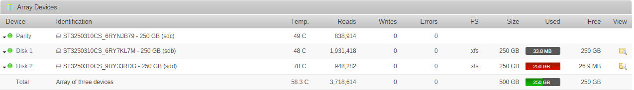

Read and write counters are no indication of actual reads/writes, same model disk with same file system on the same controller can have very different values, it’s normal and nothing to worry about, e.g., screen below during a parity check.
