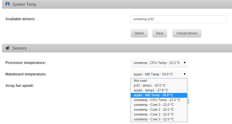

I have an HP ML10 Gen9 Server.
This server should have from my understanding a Mainboard Temp Sensor and an Ambient Temp Sensor.
I installed dynamix system temp and I got the results from the attached picture.
1st question: I guess that apcitz temp 0 is the mainboard (higher value) and the apcitz temp 1 the ambient sensor (a little bit lower temperature)?
2nd question: Can I also display the ambient sensor in addition to the mainboard sensor?
3rd question: what could be the jc42 temp?
