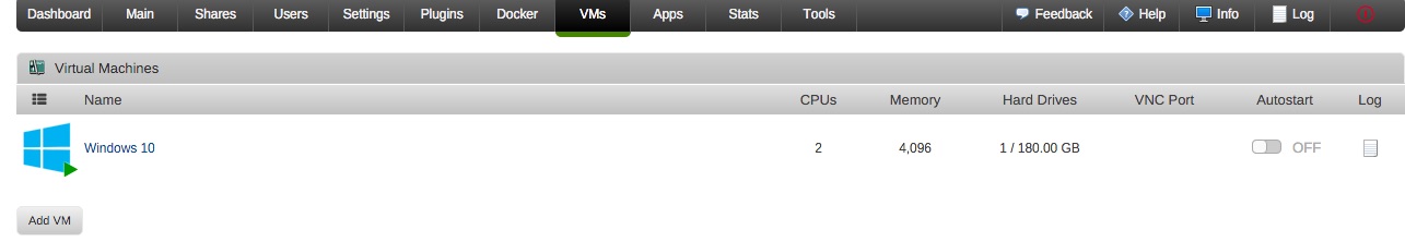

From my UnRaid server, if I go to the VM tab I see this the details of the virtual machine

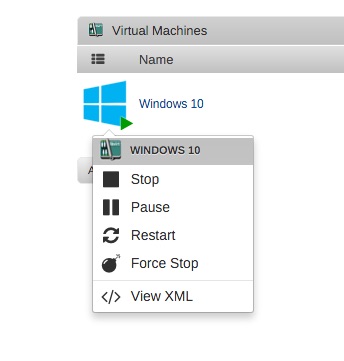

If I click on the actual VM icon, I get more options.
When I start up the virtual machine, my monitor comes to life and boots windows, I can then login and play games on this windows 10 virtual machine that is actually running on my UnRaid server.
