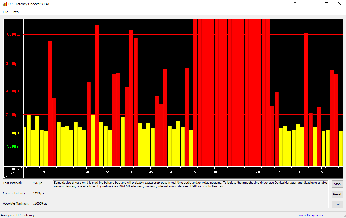

Here is a DPC Latency result using the same settings as i have in my XML in the first post.
Sometimes i get huge spikes, and it does not seem very stable, this test ran while i was running Guild Wars 2.

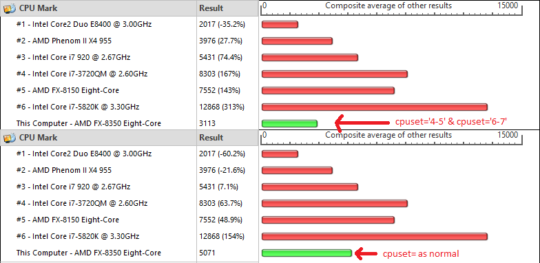

I did this and i got way less scores when trying to use 2x cores for each vm core, so i would say unraid dont support this, unless there is some other way of doing it that i am not aware of. When looking at the forum i posted about earlier it seems that vfio supports this outside of unraid.
Edit:
To clarify the picture, upper test is
  <vcpu placement='static'>2</vcpu>
  <cputune>
    <vcpupin vcpu='0' cpuset='4-5'/>
    <vcpupin vcpu='1' cpuset='6-7'/>
    <emulatorpin cpuset='2-3'/>
  </cputune>
and then the bottom test is
  <vcpu placement='static'>4</vcpu>
  <cputune>
    <vcpupin vcpu='0' cpuset='4'/>
    <vcpupin vcpu='1' cpuset='5'/>
    <vcpupin vcpu='2' cpuset='6'/>
    <vcpupin vcpu='3' cpuset='7'/>
  </cputune>

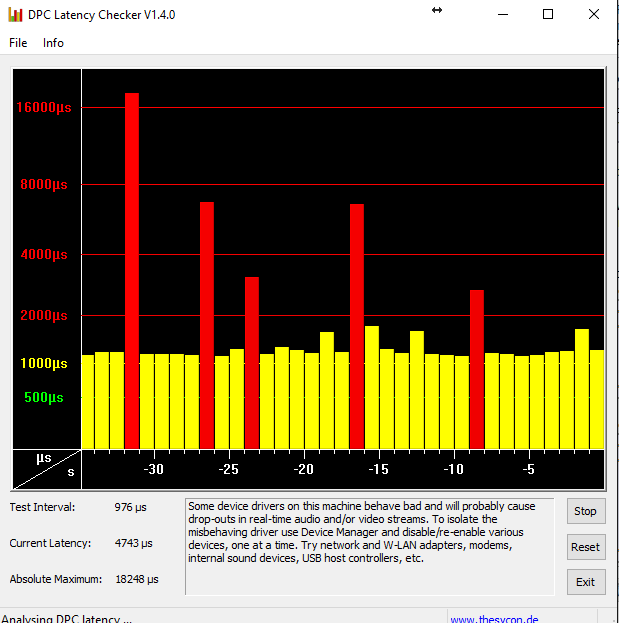

I decided to see what the latency checker says for me, even though I don't feel lag/etc...
I moved the windows I had open around, pinned to the left, right.
Anyhow, almost every time I did it, I got a bad red spike
However it never felt felt anything other than as expected, bare metal, etc...
My mouse doesn't jerk, jump, nada.
Now you have a real issue with a game, and that is certainly not normal, however I think the latency checker results at times can be taken with a grain of salt. I do GPU accelerated playback regularly without issue, and 1080P YouTube play without any issues either. I don't have a 4k output like you however.
Didn't expect the result to look this bad.

That is definitely not working. Is it supported by the qemu unraid runs?
The score for the 4 cores looks good compared to around 9000 on all eight cores.
Edit: I read about the cputune section now and I think you have an error in the first setup with two vcpu and 4 host cores. You have set emulatorpin cpuset=2-3 and this overrides the vcpupin above if I remember correctly.
So try to change it to 2-5 or which cores you want the host to use.
