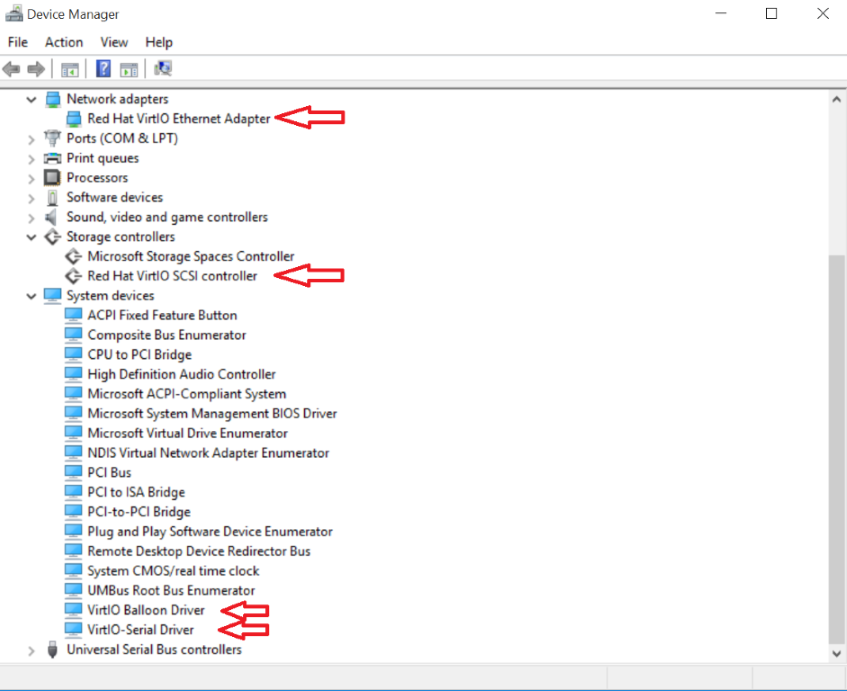

As for Virtio, these are the drivers you install for network, storage controller, balloon (ram), and serial.
If it was HDD related, I'd recommend updating the storage controller one. Have you ran any HDD benchmark's like Crystal, or similar?
I DO think it's CPU related, but, I was surprised to see the results I did with latency when doing that test.
You can update the ones with the red arrow by the normal way you update Windows drivers, just pick the version of Virtio you plan to test from the fedora site (don't have link at moment, the VM add page links to it).
I installed ethernet from a virtio iso and i used it when i added a driver at install to get my win10 to recognize the vdisk, is there something else you can do with it?
Since you asked this, did you follow the directions from here when doing the install (the order supposedly matters, but I doubt the order would cause your issues!)?

I loaded only viostor driver on install and then installed the rest when windows was installed, i used version 112.
You should fix this, go into the device manager and install what is likely missing.

Disabled cool "n" quiet in bios, made sure i had the latest virtio drivers with no unknown/other devices in device manager (everything updated) and downloaded the tool "MSI_util" my GPU was already checked but i made sure to check my hdmi audio and integrated audio. Restarted computer and tested GW2 again, still getting the same problems, it does seem to run slightly better then b4 all the tweaks i have been doing the past few days, but its is not nearly close to bare metal.
