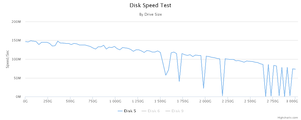

Could be a disk with slow sectors, those can’t usually be detect with SMART info.

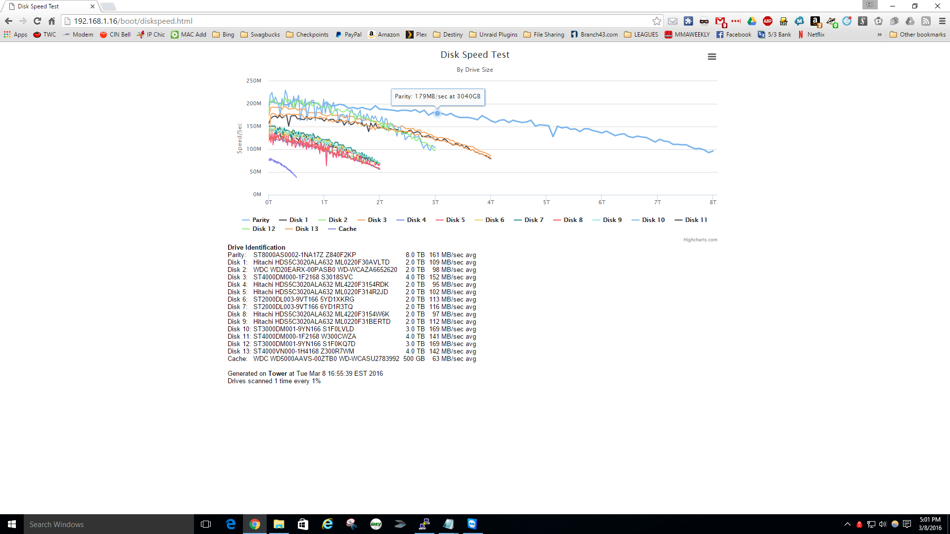

You can try running diskspeed with these options:
diskspeed.sh –f –s 101
You have to stop the parity sync and it will take some time, like 15 minutes per disk, look for a graph like the one below, if they are all ok I’m out of ideas.
Screen shot of diskspeed
Looks normal, I'm out of ideas.
Maybe someone else will see something in your logs, in the meantime re-start the parity sync,  hopefully with the crc issues resolved it will complete or help find the problem in case of more errors.
