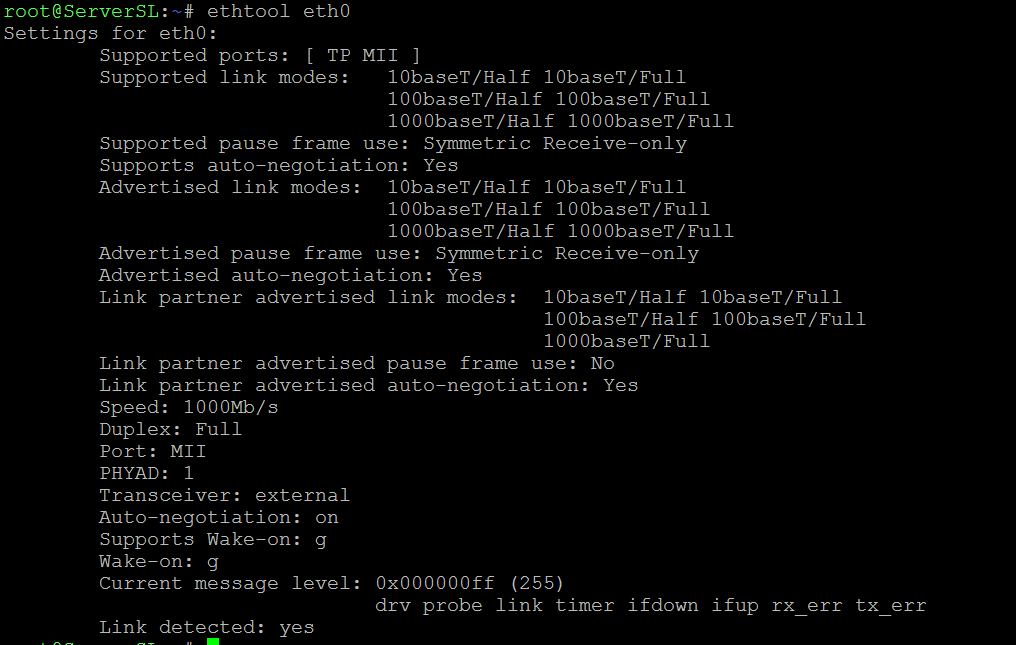

Post diagnostics, or go to command line and post results of
ethtool eth0

Ther it is
The server is connected at 1Gbps.  What is your desktop connected at?
On the same switch

solved my problem. I was so noob. My network card was set for a maximum of 10MB/S.
