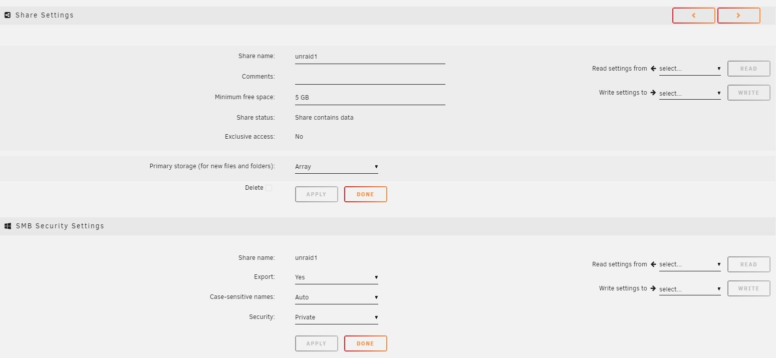

  2. I dont have this plugin installed. Maybe the original poster @Garthy There is some confiuration that got lost in the update process. As @JorgeB already pointed out, the cache was disabled after the update. If i run my backup user script, the data is stored on the cache and because the lost config never moves away from there. Whatever, everything works fine now. Thank you all very much for the fast help.
  3. As you can see in the screenshot, there is nothing to configure in the share settings since 7.0. New data always is stored on the cache disks and the mover moves it to the array. That also work in 7.0 until the point that the mover should move. I downgraded to 6.12.14 and updated to 6.12.15 and everything works fine. Heres the diagnostics from 6.12.15. Somthing wrong is happening within the update 7.0. EDIT: I get it, somehow the configuration of the share get lost in the update process. I changed the configuration now to Cache -> Array and test again... unraid-diagnostics-20250126-1345.zip
