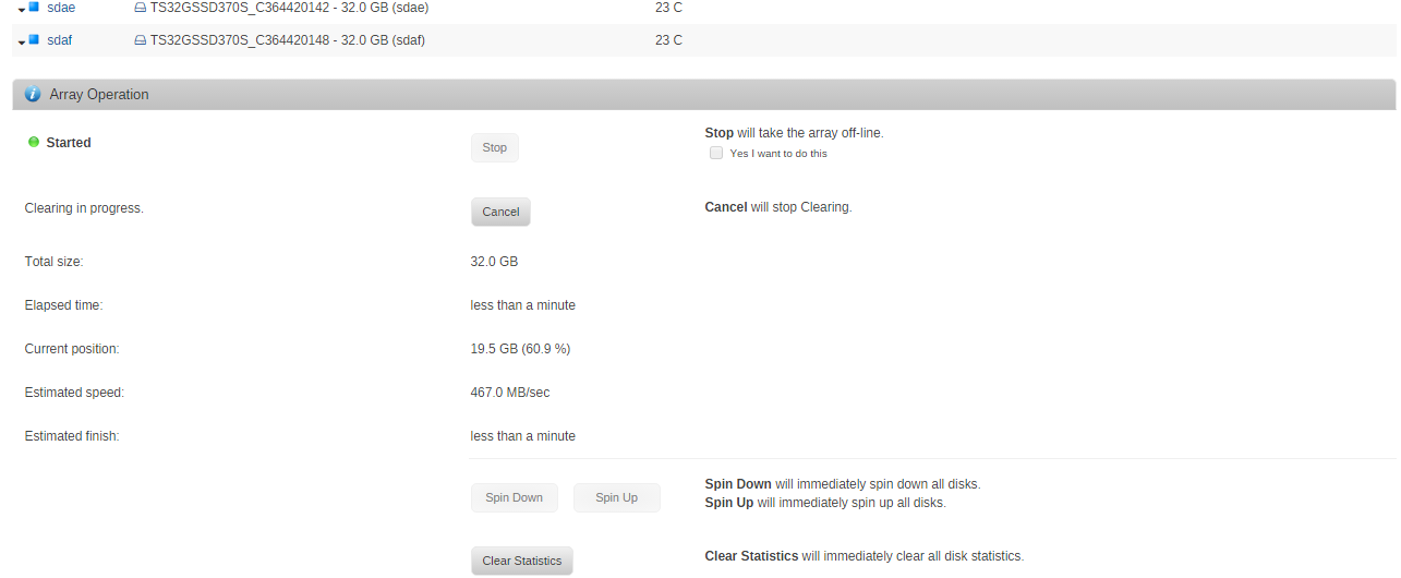

There no options and no notifications, looks like this:
syslog:
Mar 29 21:40:11 Testv6 kernel: mdcmd (42): check CORRECT
Mar 29 21:40:11 Testv6 kernel: md: recovery thread: clear ...
Mar 29 21:40:11 Testv6 kernel: md: using 8192k window, over a total of 31266616 blocks.
Mar 29 21:41:21 Testv6 kernel: md: sync done. time=70sec
Mar 29 21:41:21 Testv6 kernel: md: recovery thread: completion status: 0
screen:
syslog:
screen:
