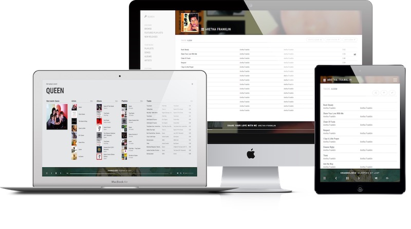

And possibly a docker of Mopify, a Mopidy front-end.
https://github.com/dirkgroenen/mopidy-mopify
