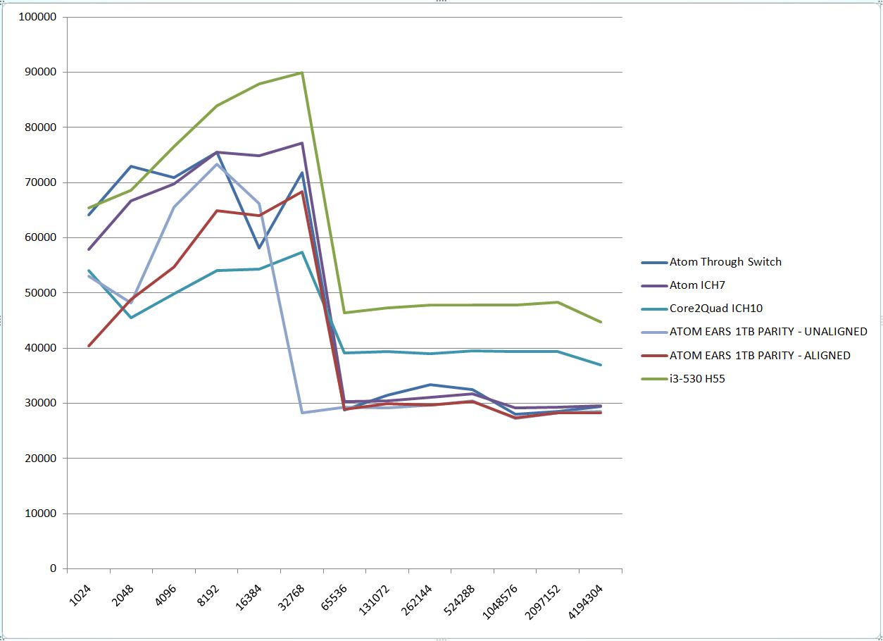

I moved the same pair of vRaptor baseline drives over to a new i3-530 H55 platform tonight.
The board used is an ASUS P7H55-M PRO motherboard.  The board has 6 onboard SATA 3 ports and the processor has on package video.  Since I thought this would be a good blend of performance and power consumption, I also took power measurements below.
Same configuration as the other systems with the exception of the physical necessities of the platform (4GB DDR3 instead of 4GB DDR2).  I am still working on the write tests, but the read performance seems to scale quite a bit depending on the platform.
Note that I have not adjusted any unRAID parameters to attempt to optomize for the 4GB memory.  It is completely stock.

I'm blown away by the power consumption numbers on the i3-530.  I knew it would be close, but I am shocked that it actually beats the overall power consumption of the Atom 330 ICH7 with onboard video.  I haven't actually timed it, but unRAID is operational in less than 30 seconds after power on with the i3 while the Atom system chugs and takes several minutes.  The read performance on the identical drives is up 55% from the numbers posted by the Atom based board.  I haven't finished the write performance test, but early numbers look very similar to the results of the Atom and Core2Quad posted earlier.
As would be expected as the Atom has an ICH7... you are really comparing chipsets and mobos, not CPUs.
And you are getting huge buffer effects... you have to account for buffers by tying up 90% of RAM to prevent it from being used by buffers.
It seems there is more going on here than just the chipset.  I don't see how to explain the similar boost in read capacity from the Core2 Q8300 to the i3-530 on H55.  My understanding is the ICH10 architecture is comparable to the H55.
Also:  with the power draw where it is, why would a person not favor the additional processing potential of a core i3?  Based on the results so far, I am leaning heavily toward this platform for the blend of performance and efficiency I have seen.  However, I'm certainly not finished with evaluating everything yet.

I received a second WD10EARS 1TB drive yesterday and installed both in the i3-530 system (my current "best case" system).  The system now has a matched pair for Parity and Data.
The read performance was outstanding.  Read throughput actually EXCEEDED the (2) vRaptors.  However, write performance declined as expected.  I will post the comparative numbers tonight.
EDIT:  Reran this test and the read performance was not as high as reported last night.  Still not bad:
Parity:  WD10EARS, Data:  WD10EARS
Write:  28% slower than vRaptors
Read:  9% slower than vRaptors
