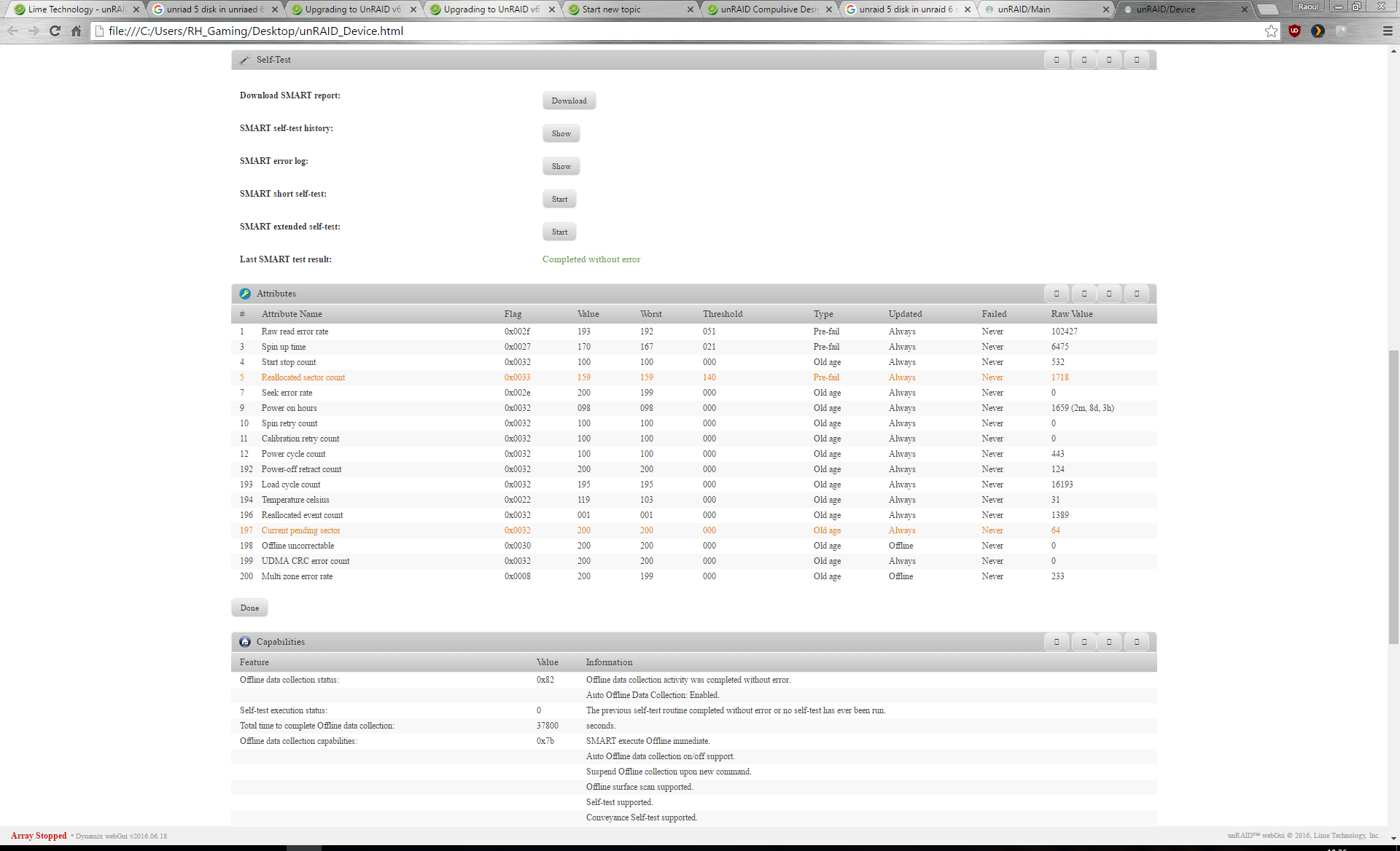

PIC 1

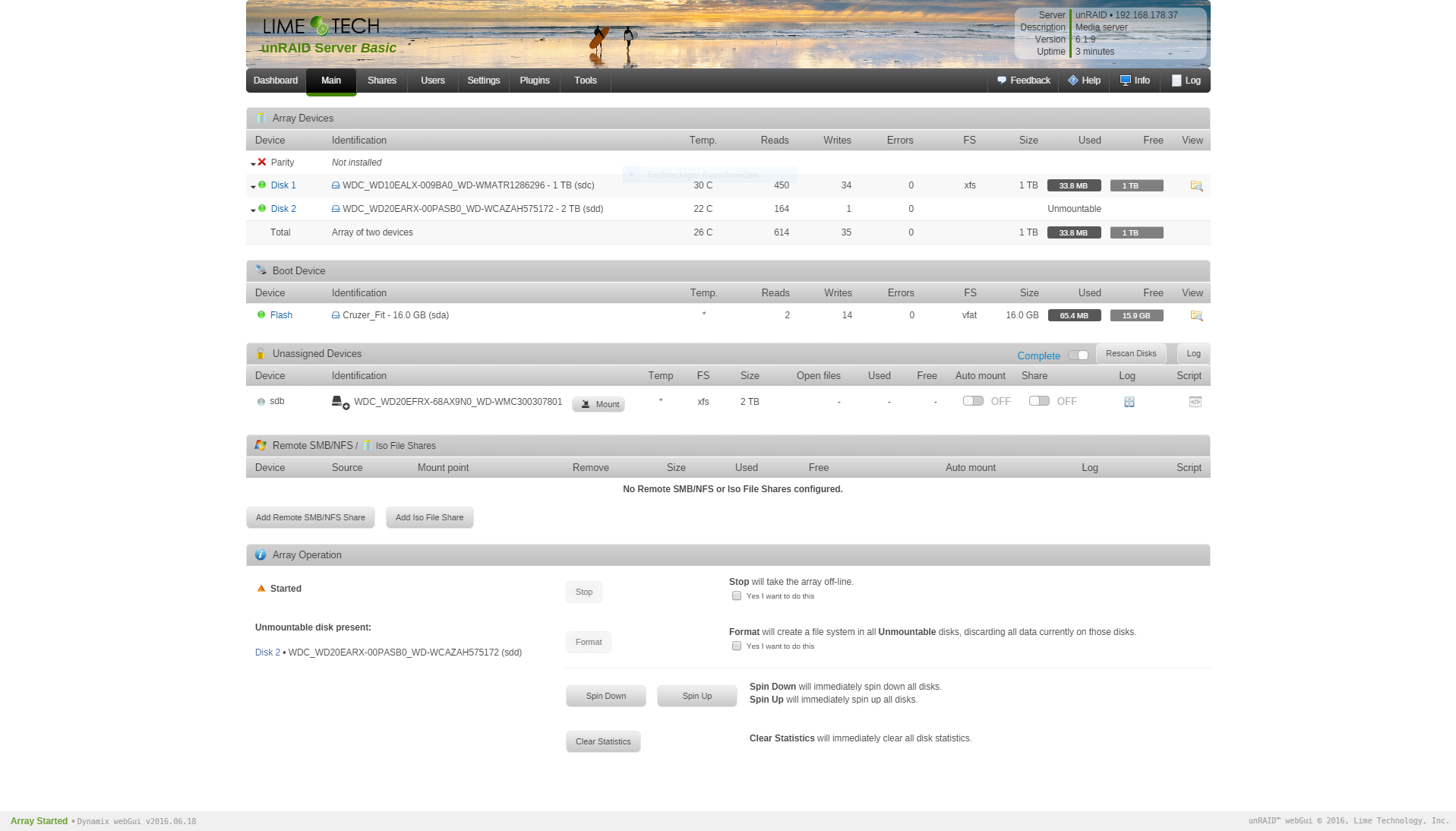

PIC 2

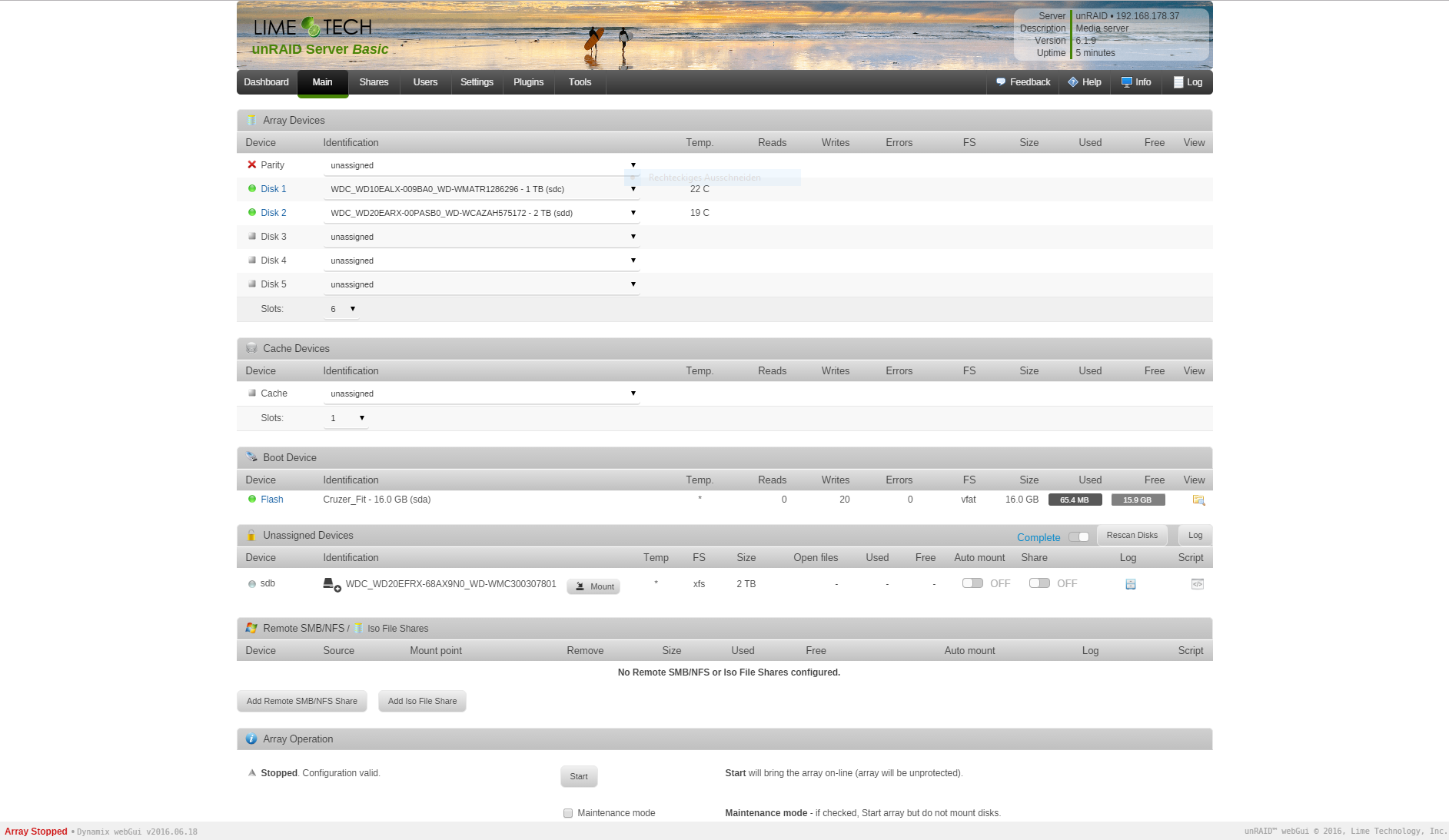

PIC 3

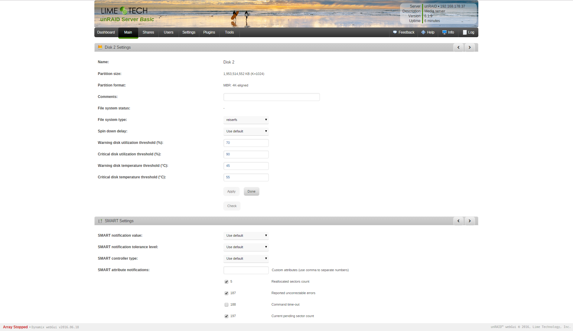

PIC 4 (mounted under win10 with sata-usb-interface, didnt shown correct)

The screenshots seem to refer to disk2-5172. PIC 2 shows that disk shouldn't be used in unRAID due to its bad SMART. Is that the disk you want to get the data from?

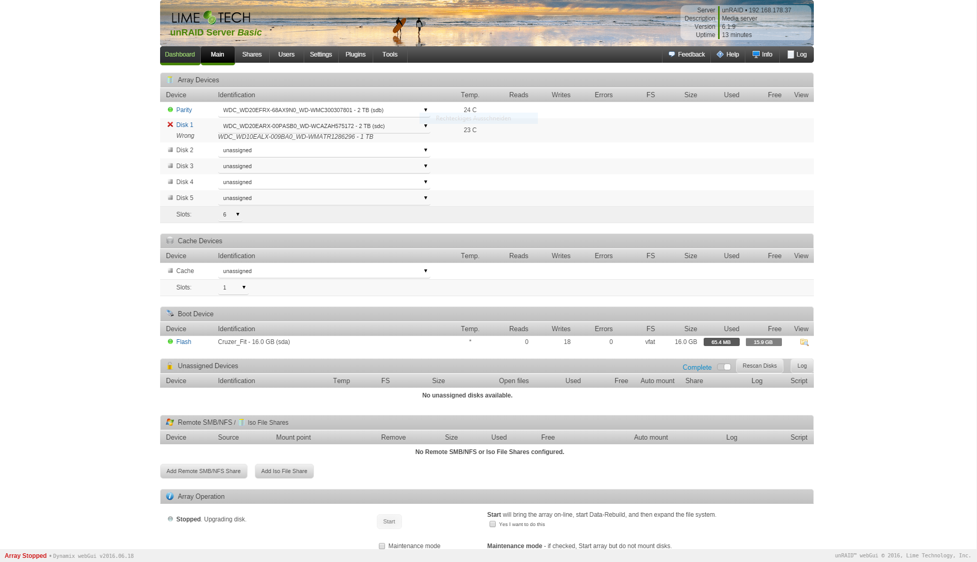

Excuse me, my mistake. This weekend i can finally work on my server again. It will re upload my syslog. Just like i had it, just 2 disks.

Here's my unraid diagnostics. Like it was on unraid v5 setup. Parity: 2TB WD RED (WDC_WD20EFRX-...) Data: 2TB WD Green (WDC_WD10EALX-...)
The data drive is the one i can't loose, so i'll have to  try to save it to an external drive or s.th. similar.(looking into "trurl's" guide)
unraid-diagnostics-20161030-1044.zip
Your latest description doesn't match the drives in your screenshot or in your diagnostics. The missing drive in the screenshot is a 1TB serial ending 6296. That drive does not appear in syslog or smart.
There is a 2TB unassigned drive in syslog and smart. Do you want to rebuild the missing 1TB onto the unassigned 2TB? That unassigned 2TB drive has SMART issues and I don't recommend using it in unRAID.
Or do you instead want to get the data from the unassigned 2TB? If so what about the missing disk1?
Please clarify.

I see you were able to see the drive in Windows 10, but you would have had to install a ReiserFS driver, before you could actually see the files on it.

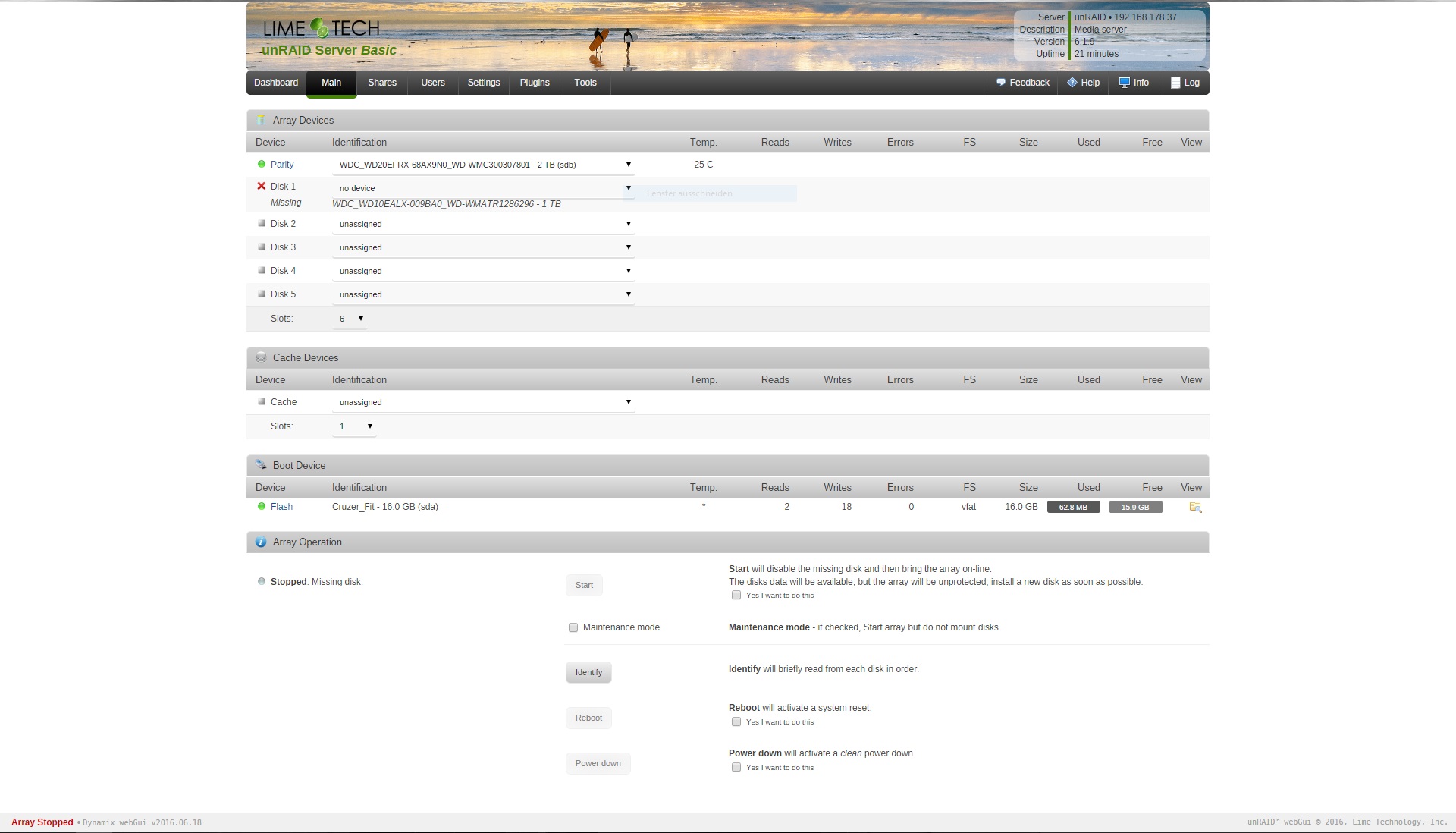

:-\ my fault, see attachment!
I want to save my data from the  2TB WD Green(WDC_WD10EALX-...) unassigned drive you see in the syslog and smart logs. I dont really know the best way to that,...
The 1TB disk i pulled out of the system to get the original setup of my server (one 2TB WD Red as parity,  one 2TB WD Green as data)
For me it seems like after pulling out my 2TB  WD Green and using a 1TB WD Drive, my server made a new parity... So now it's looking for the 1TB Drive...
My next step ist to put my server in its original setup, let the parity do it's thing. That should be fine or not?
WDC WD10EALX-whatever is not a 2TB drive, it is a 1TB drive, and it would be better as I mentioned to refer to the last 4 characters of the serial, since many drives will be identical for the first many characters.
This does not make any sense either. The only way you would get unRAID to "made a new parity" is by setting a new config and letting it build parity, which would have taken a noticeably long time.
I don't have any idea what you mean by "let the parity do it's thing". Maybe you don't either.
The latest screenshot is showing 7801 as parity which matches what we already saw. But I don't think we can assume anything about parity without a very clear and detailed description of how you got to this point. Probably best to just concentrate on the data disks.
Which drives exactly do you have data on that you want to keep (please specify last 4 digits of serial for each)? Are all the drives you have data on that you want to keep actually connected to your server in the latest screenshot?
The latest screenshot is showing a 1TB drive ending 6296 as missing, and it has been replaced with a 2TB drive ending 5172, which I think may be the drive you are talking about trying to get the data from. As already mentioned, that disk has problems and should not be used in the array again, but it might be possible to copy the data from it.
So, assuming 5172 is the 2TB drive that you want to get the data from, what about the missing 1TB drive 6296? Does it also have data on it that you want to keep?

Go to Tools - New Config.
Assign the 1TB drive 6296 to disk1. Assign the 2TB drive 5172 to disk2. Don't assign any drive to parity.
Then post a screenshot showing Array Devices and Array Operation.
Here it is:
Looks like the 1TB already has an empty XFS filesystem on it, so unRAID must have formatted it at some point.
Unfortunately, it doesn't think the 2TB drive with your data has a filesystem, so it is offering to format it. DON'T DO IT.

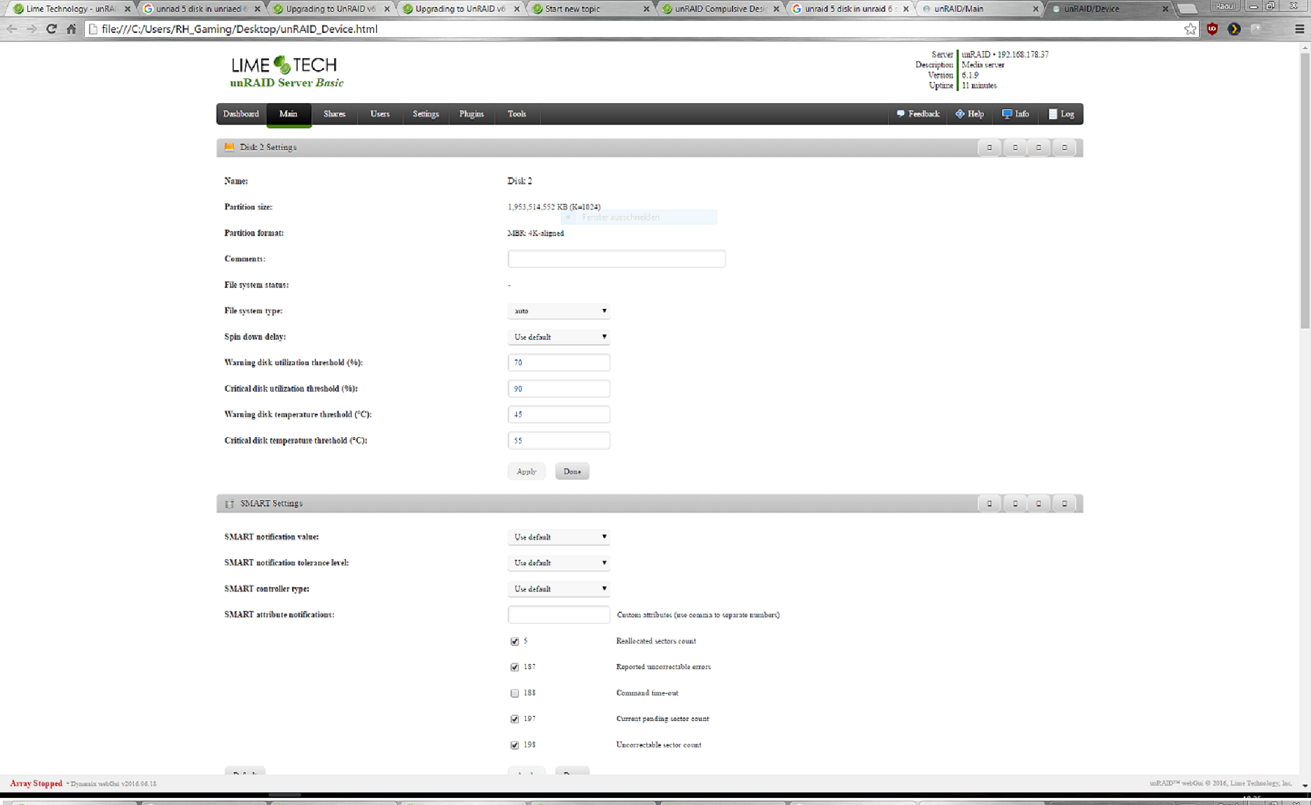

Since the disk was used in V5, it should be ReiserFS. I'd try manually setting the file system type in the disk setting to Reiser and see if it mounts.
Do you know what its filesystem is supposed to be?
Sounds reasonable.
You will have to Stop then click on Disk 2 to get to the page where you can choose its filesystem. Post another screenshot if you get stuck.

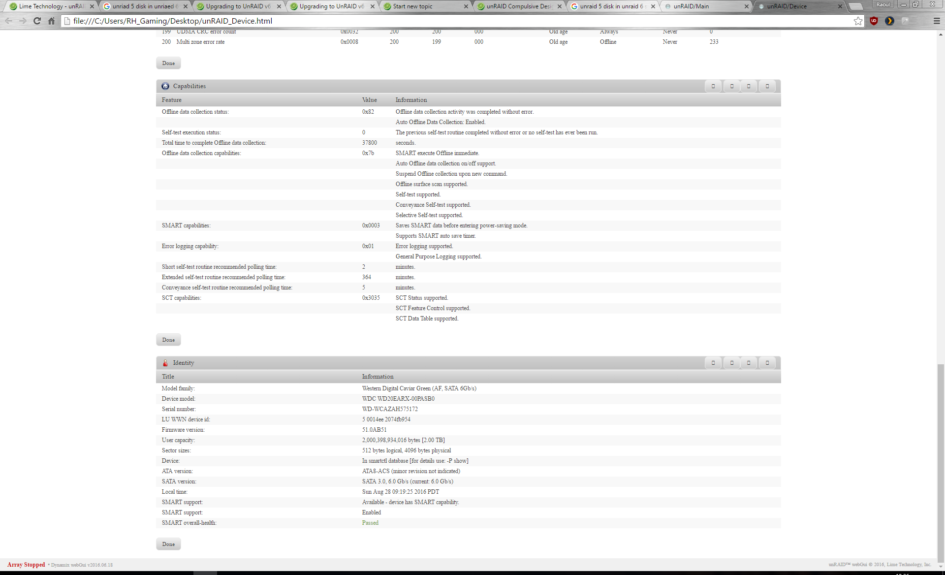

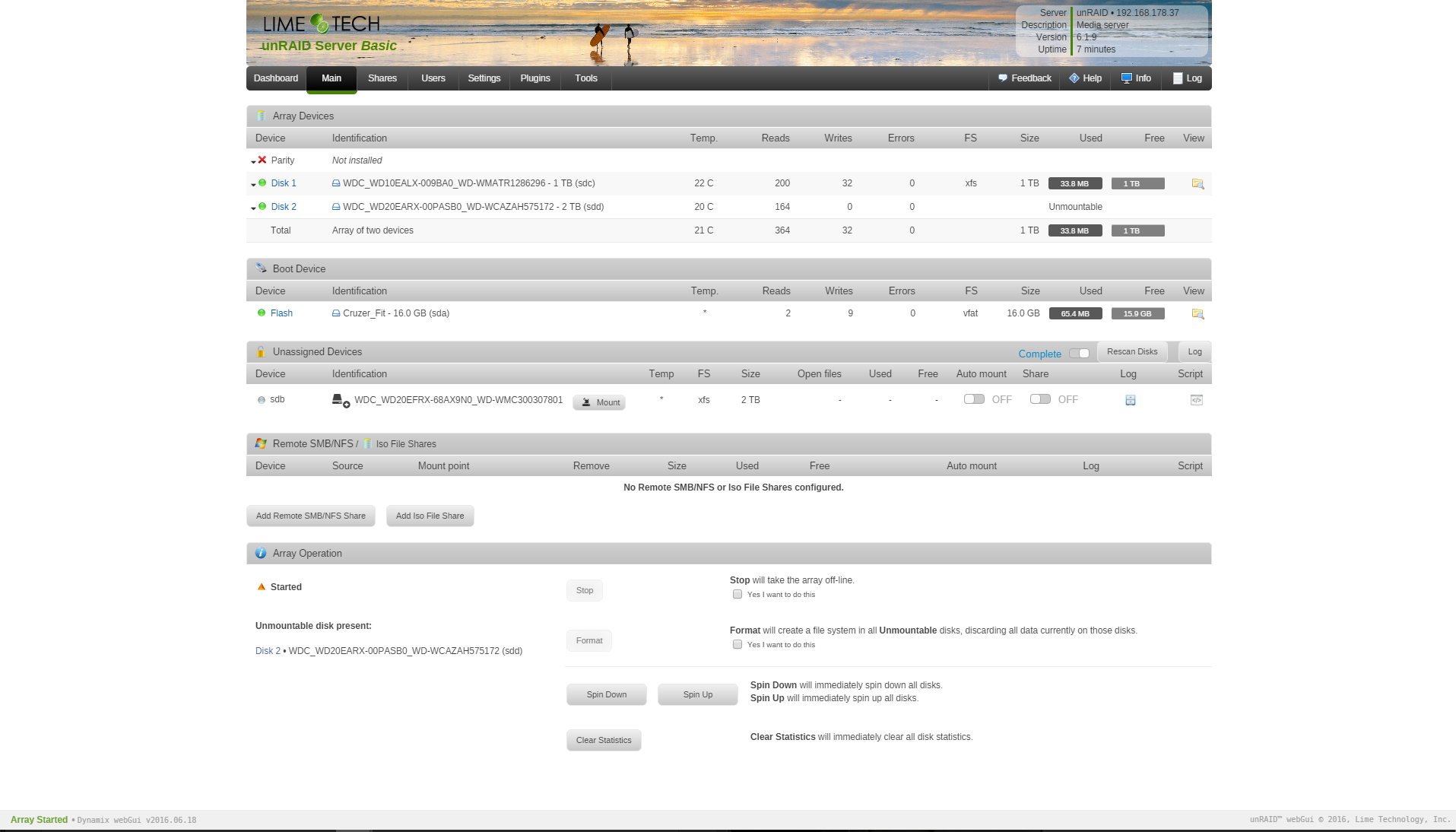

I tried it out(ReiserFS,see screenshots), It's says: "unmountable Disk"
After that i tried to mount it as the other two disk formats(xfs and the third one), same result:"unmountable Disk"
Pic.2
Pic. 3
