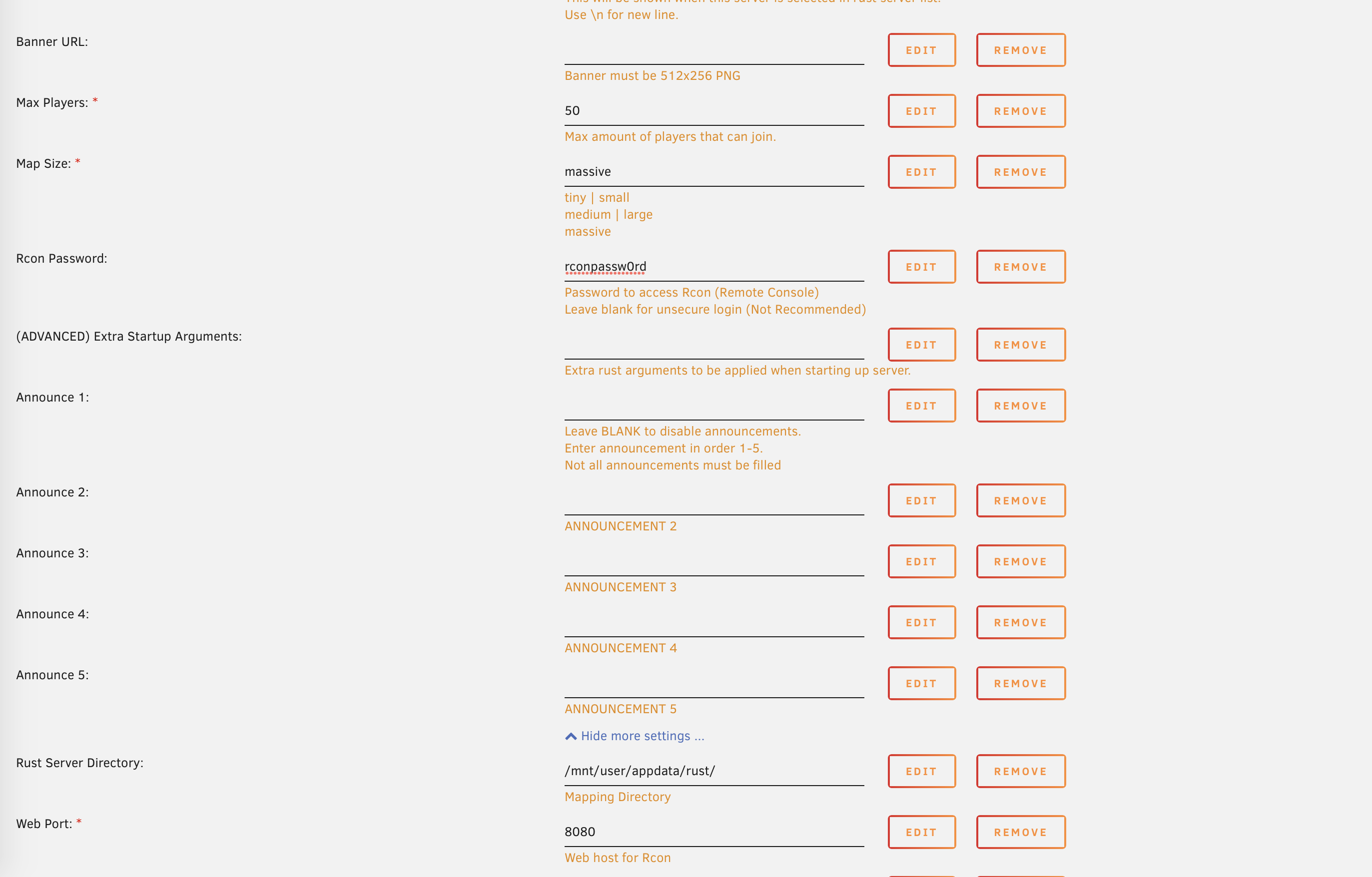

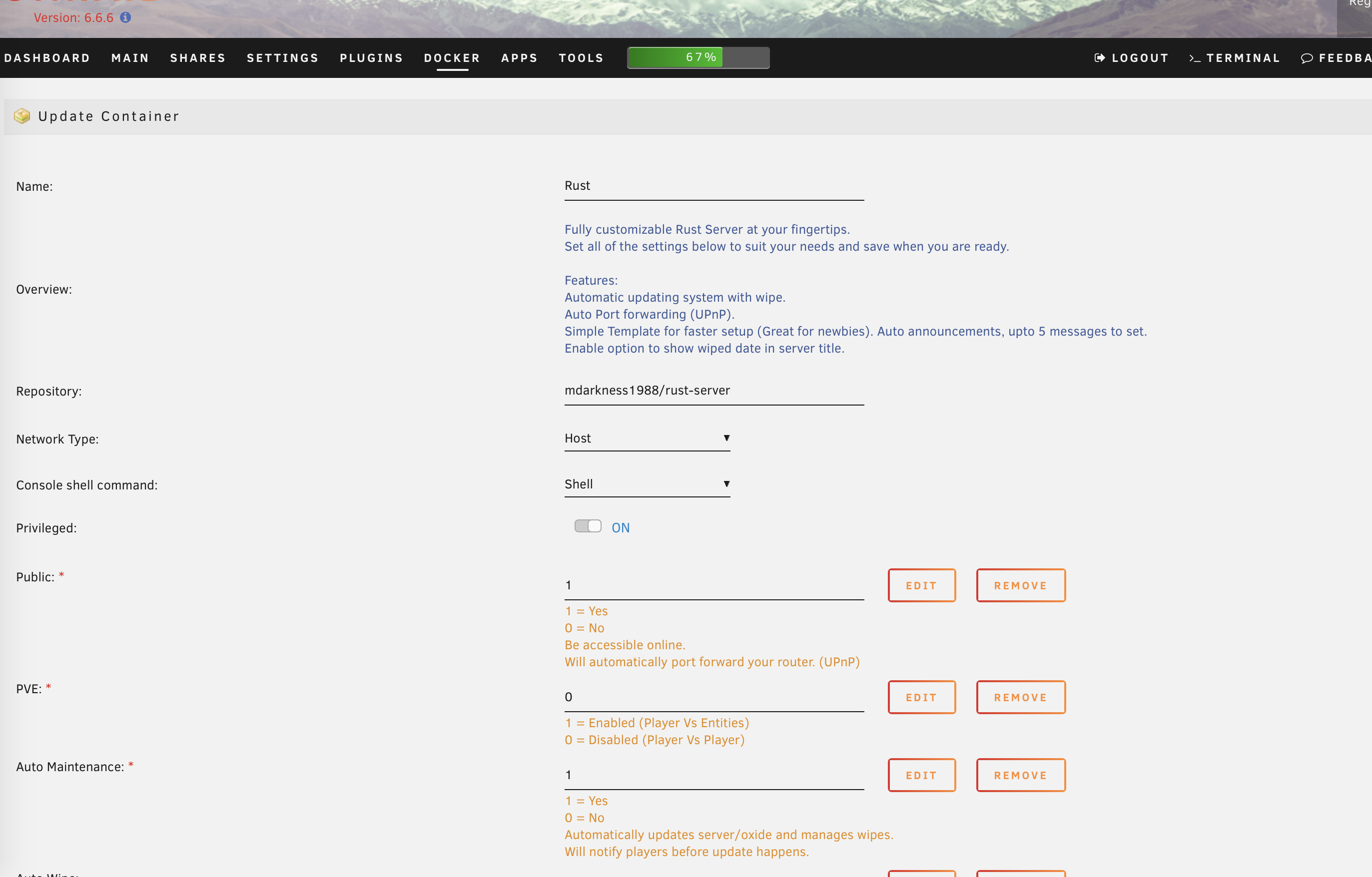

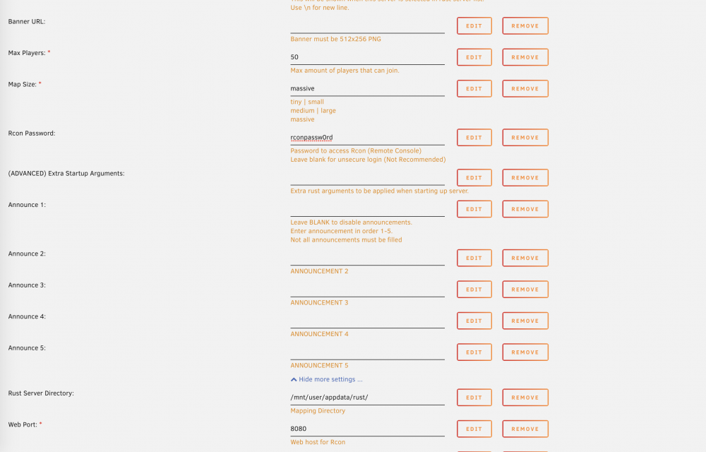

February 17, 20197 yr 5 minutes ago, Mdarkness1988 said: Screenshot of the rest of the config please and does it even startup? I mean, it seems like it starts up but I can't see anything in the RCON and I can't connect locally. I attached the rest of the config and the full server log from startup. Thanks for your help; I greatly appreciate it. rust-server.log

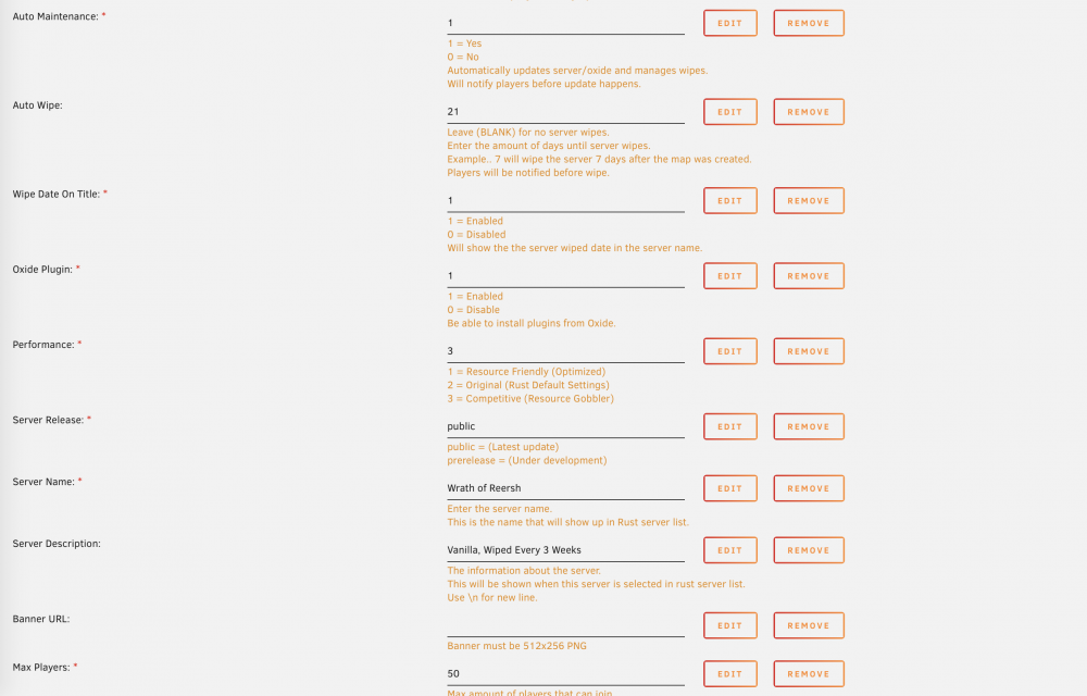

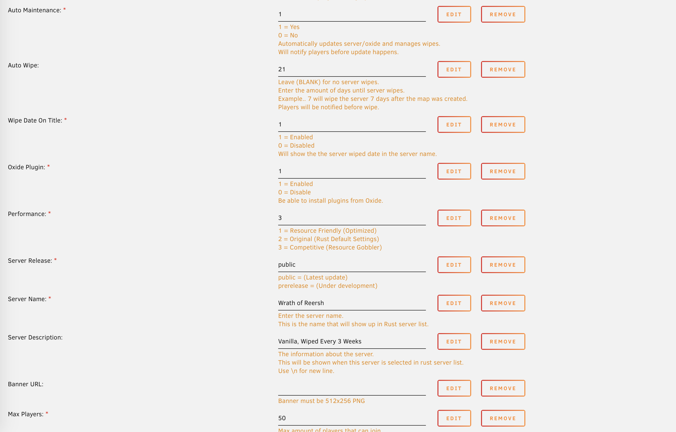

February 18, 20197 yr On 2/17/2019 at 11:23 AM, Mdarkness1988 said: Any chance it could be your VPN conflicting as I tried Ur setup and no issues here. And what router you got. Thanks So I let it just run and it took about an hour for the NetMesh or whatever to setup fully? I had selected massive map but anyway, it finally started. I and two of my buddies connected it but the lag was unplayable and I have no clue why. I do have a DelugeVPN docker active but that VPN info should be private to that container. I'm just not sure why my ping would be so bad. I'm on FiOS with a (assumed) beefy server. I allocated 10 of 32 threads to server but it didn't help. I restarted the docker and it took another hour for it to start back up (very weird!!) Any ideas @Mdarkness1988?
February 18, 20197 yr 16 minutes ago, seventhaxis said: So I let it just run and it took about an hour for the NetMesh or whatever to setup fully? I had selected massive map but anyway, it finally started. I and two of my buddies connected it but the lag was unplayable and I have no clue why. I do have a DelugeVPN docker active but that VPN info should be private to that container. I'm just not sure why my ping would be so bad. I'm on FiOS with a (assumed) beefy server. I allocated 10 of 32 threads to server but it didn't help. I restarted the docker and it took another hour for it to start back up (very weird!!) Any ideas @Mdarkness1988? Have you tried on setting 1 on performance settings and not setting 3?
February 19, 20197 yr On 2/18/2019 at 11:46 AM, Mdarkness1988 said: Have you tried on setting 1 on performance settings and not setting 3? That seemed to fix it. I don't know why I changed it (or why it doesn't work) but it's working now. Thanks for your help @Mdarkness1988!
February 19, 20197 yr 11 minutes ago, seventhaxis said: That seemed to fix it. I don't know why I changed it (or why it doesn't work) but it's working now. Thanks for your help @Mdarkness1988! Setting 3 is for the most extreme servers with great internet speeds
