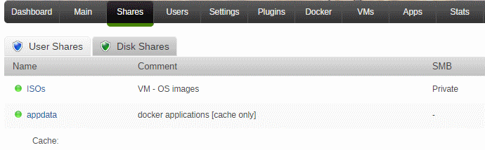

Shares still appear to be on a data drive not a cache drive.
y3miWPCaXndxF7yuSZSM0ESW4zImfAAeD7Oux5-xkDJFQcsl-K9KYfgZ6vUZToUCsPsqOQv66QRjrbV18jf_oOFwDQpJqnZtXiqZjs7YnciC3Ih81TK8V-N35JxfzWMajbso1Xob0UvLM5wivGMDQ0fhgssKIvjMPwl9eRvojYgIsQ?width=1024&height=431&cropmode=none
Did you run mover ?
When you click on compute, it will show on which disk(s) content is found for that share (see my example).
yes
y3mqUD_Zvwf-epQLMoGHMD4xnPQsRR1LYCwyHJGR3-D7Ifzj11AfsUDftoSS9ZUMFhunLsqGn3mm1TB7OSw17eYjdq6N4PbKypzK65stOfPIh9dIVxYy26WAyvZjyOSlPUX5hlViNrSLTTYAWIyZdoXwWOZut3Y8yXtmDegx3osZns?width=1024&height=457&cropmode=none
I guess it is not moved because there is no content (yet) in appdata (I presume you have a Cache disk now)

Since setting is "Cache only" it is the reason why nothing will be moved (if any content), but it is puzzling why the setting isn't "Prefer" and the share is on disk1, unless the share "appdata" already existed on disk1 before...
It was prefer but I changed to cache only.
Ok, and did you start the mover after you made the change?
yes
yes
ok, try this...
Change setting back to "prefer" and start mover.
That worked except for the system folder.
Great.
That is expected. System folder resides on a data share.
