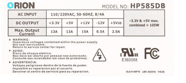

Look at the spec's on the side of this unit (attached) and use your calculator.  Your CPU alone has 125W power envelope!  And then there is the SATA card and the Graphics Card...
Wow...thanks for pointing that out...clearly I don't know much about PSUs...I have always went off of the Wattage that they claim (the one in there said 585w, so I plug it into a calculator with all my components and it said I needed 380, assumed I was good), never looked into the wattage breakdown across the different rails...Learn something new everyday  :P:-[???
Looking at the attached PSU now...
The graphics card specs say it runs off of the 12V rail, requiring 350w.
Cant find any power requirements on the SATA card.
Hopefully this PSU is enough?

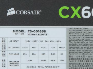

Personally, I wouldn't trust that supply, as the manufacturer is completely out to lunch

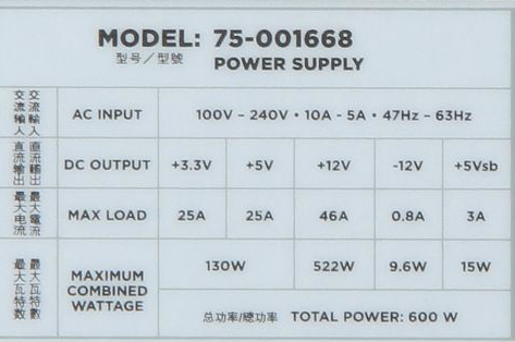

#1 - As stated, the 12V line pumps out 46A which they state is 522W.  Incorrect 46A is 552W.  522W is actually ~ 43A
#2 - Total Power as listed is 600W.  Most manufacturers will list the total output as the 12V rail capacity.  In this case, it should be either marketed as a 550W or a 525W supply - If the label matches the actual components  (Other manufacturers will add up the capacity to market the supply as - Either way the label doesn't make any sense)
If they can't even manage to calculate the power correctly on the label, who's to say that the power supply is even pumping out what its supposed to be.  Beyond that, the label itself is so generic looking that it almost looks like the mfg just tosses the same label onto whatever supply they pick up at a garage sale.
The absolute most important component of a computer is the power supply, as everything else runs off of it.  It doesn't pay to skimp here.  And when you're looking at a powersupply that is (if it is indeed a 585W supply) is 1/2 the price of a 600W supply from a reputable supplier, I'd say there's definitely some skimping going on here...
(Even the "style" of the supply looks ancient - This is probably a cheap generic 350W (rated, but probably not even capable of handling that current) supply that's been relabelled as a 600W.
And we haven't yet even begun to talk about voltage ripple / drops as the supply approaches its actual limits

Interesting....It is a Corsair supply; I thought they were supposed to be one of the best supplies out there?

The link you posted was to a generic power supply
But even there, someone at Corsair has no clue how to do the math (And not like its hard....  Watts=Volts*Amps), nor how to add up the totals (looks like they're taking the 3.3Watts and adding it to the incorrect rating on the 12V line to get to 600W)
(Although Corsair's website does list the correct values on the 12V line)

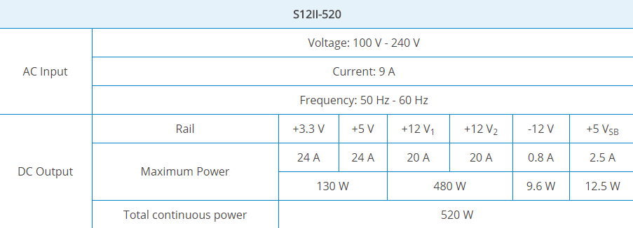

New Seasonnic PSU came in, plugged it all in, still doesn't facing 2+ minutes to post (pulled out the graphics card and data controller, and down to 1 stick of ram. Tested start up with each disk 1 by 1, all have the same behavior), and still having the crashing behaviors.

You may well be right about the motherboard, but there are 2 more things you can try.
- Do a Memtest from the unRAID boot menu, just to make sure your RAM is fine.
- Remove the CPU cooler, clean the CPU and cooler surfaces properly, apply a fresh dose of thermal paste, and reinstall the CPU cooler.  Anything that crashes under load may be heat related, so it's possible the CPU cooling is not working correctly.  Or there's a bridge chipset on the motherboard not being cooled correctly.  Make sure all fans are working.
