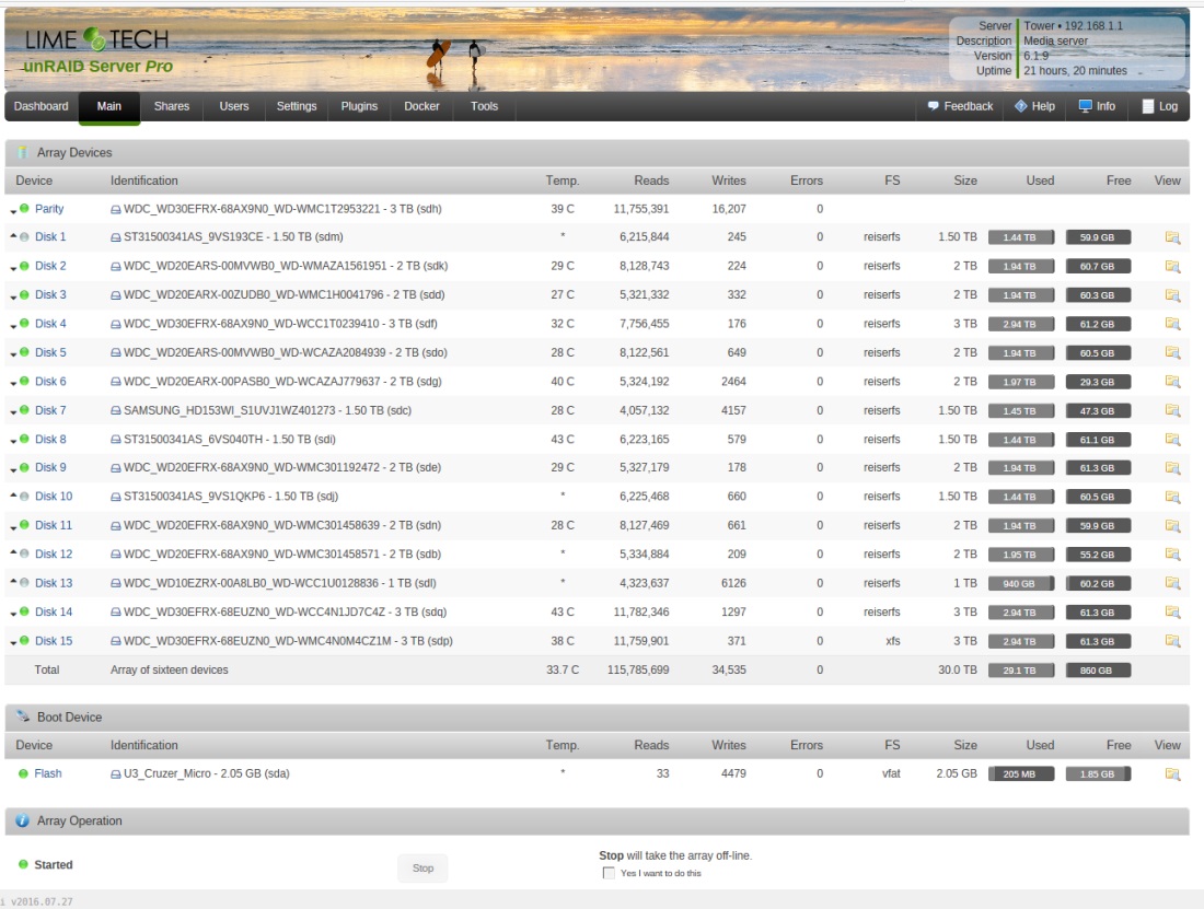

October 25, 201610 yr post a screenshot of your main unraid screen.. your running out of space somewhere..

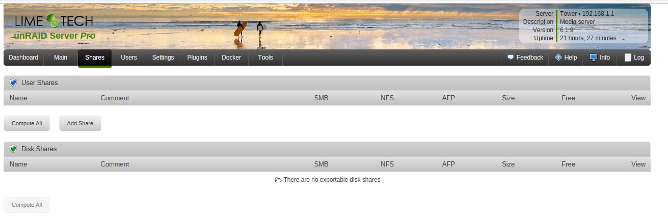

October 25, 201610 yr Author OK Attached the diagnostics and a screen image of the Shares section. Is this normal, I have three shares setup and visible in Windows and on my Popcornhour(s) but nothing shows here.. tower-diagnostics-20161025-2139.zip
October 25, 201610 yr Mobile so can't check the diagnostics but as for the shares not showing up possibly an ad blocker interfering with the display Sent from my LG-D852 using Tapatalk

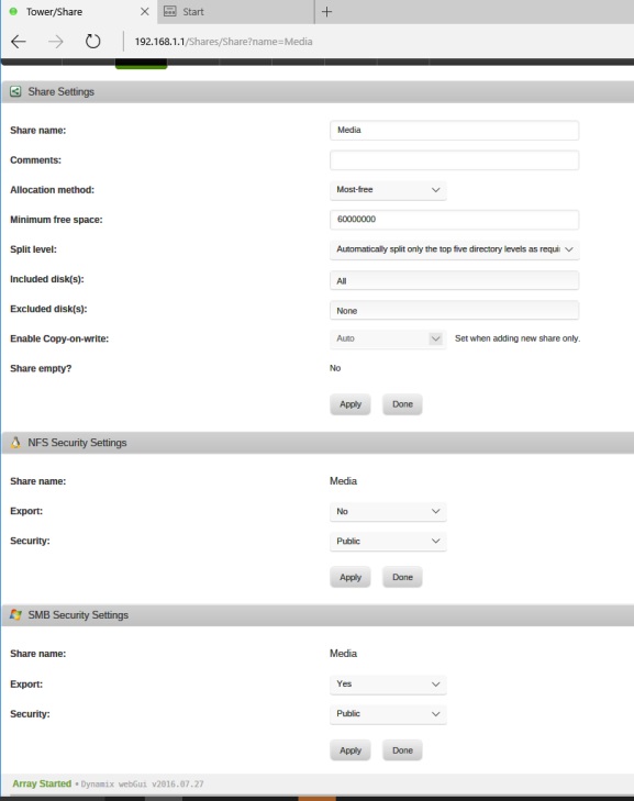

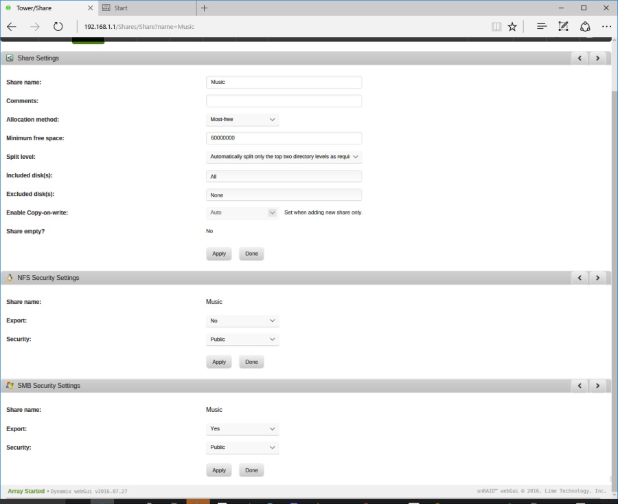

October 25, 201610 yr Author OK Thanks, tried viewing from Edge and the shares show up, will look into why that it later. Attached are screen shots for the two shares.
October 25, 201610 yr If I'm reading that right, you require 60GB free on the media share and your free space is right around there on each of the drives.. Thats why it says out of room..
October 25, 201610 yr Author You are right lowered it a bit and it works now. Got a new 3Tb arriving tomorrow. It would be nice for there to be a warning rather than the server just lock, can one be turned on anywhere?
