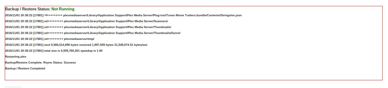

@SQUID you're a god sent! just got done with my 1st back up with CA!
i was a little worried that i would have to do the scripting since as instructed because the UD share wasnt listed but i put in the location and it found it! totally stoked now i can have my dockers running on flash and being backed up every night and not have a disk and parity drive constantly running!
So long as no errors happened during the backup, you'll be good to go.
yea no errors
check attachment..

Settings Tab...  Appdata Backup / Restore (its in the Community Applications Section)
I'll have to fix that.  Prior to a week or two ago it wouldn't have worked at all, but I made some adjustments to handle appdata being in a subfolder instead of a share by itself, and never thought about UD disks (which were previously not supported at all)

well i'm super stoked and happy you made those changes. my plex server is flying running as a UD and backing up fine with the changes.
