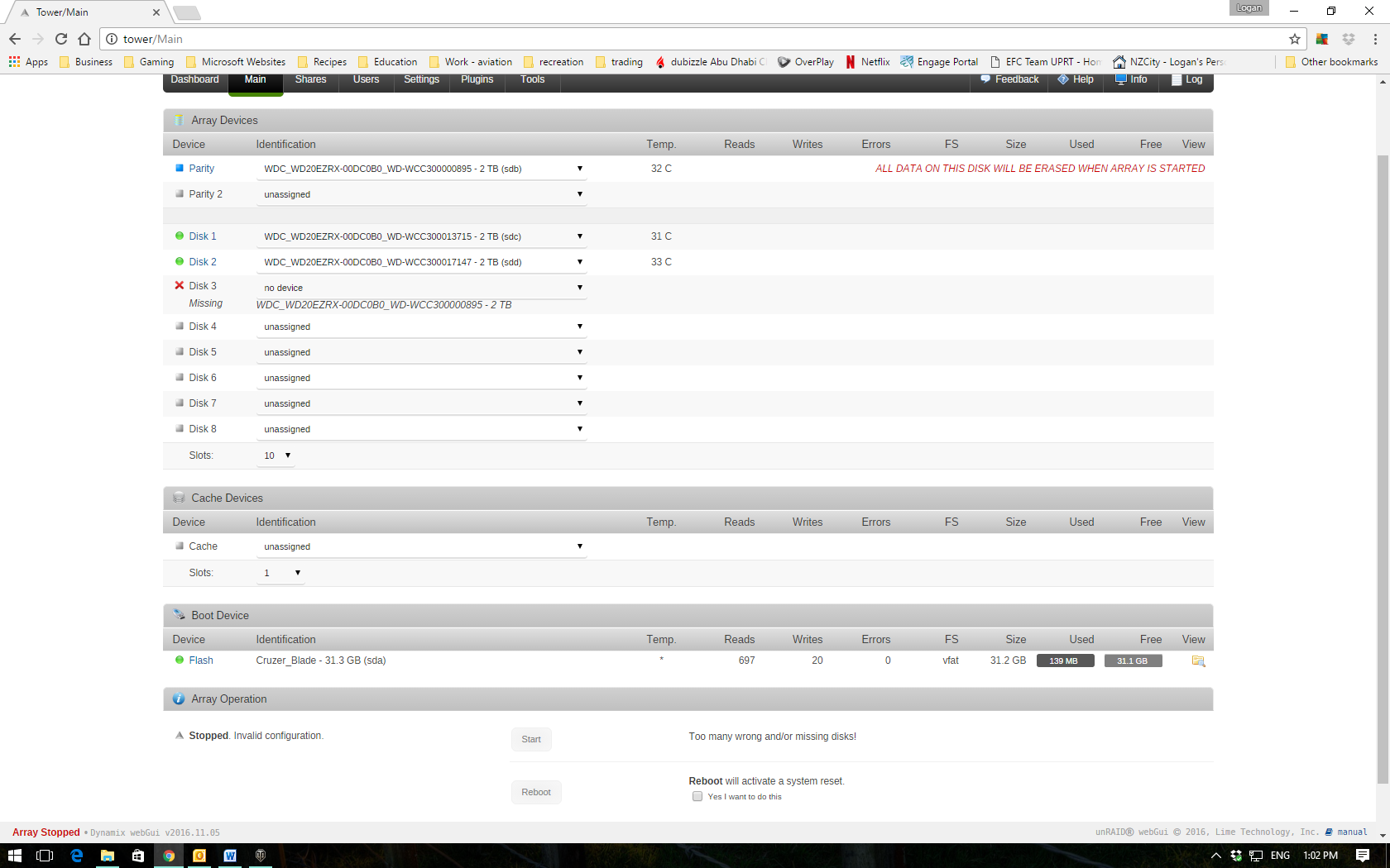

Sorry to keep asking but next issue:
Having assigned all my disks as data to id the parity drive, which worked, i then try to reassign the drive to parity slot which I can. Then I have message Disk 3 missing (because I moved it to parity) and am unable to start the array due to the missing disk.
How can I clear the missing disk from disk 3 slot? Clicking no device doesn't work.

Tools -> New config
You'll have to reassign all disks.
Thank you very much!
Now just waiting for the parity rebuild to do its thing, fingers crossed.
