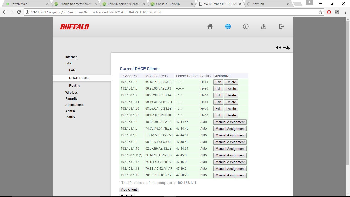

Try rebooting the router....  (I would bet that your router table now has two identical MAC addresses in it.)
No I deleted the old dhcp reservation. Just rebooted the router.

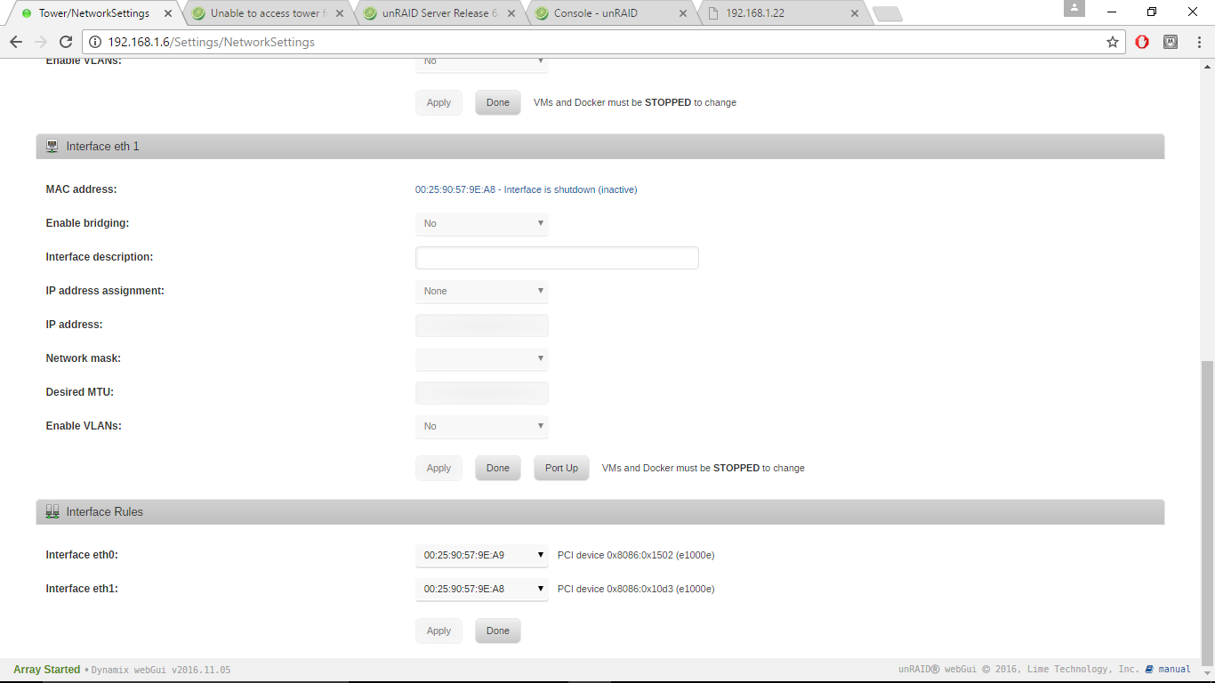

And eth1

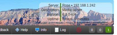

And what does it say the IP address for the server is (at the right side of the banner)?
192.168.1.6

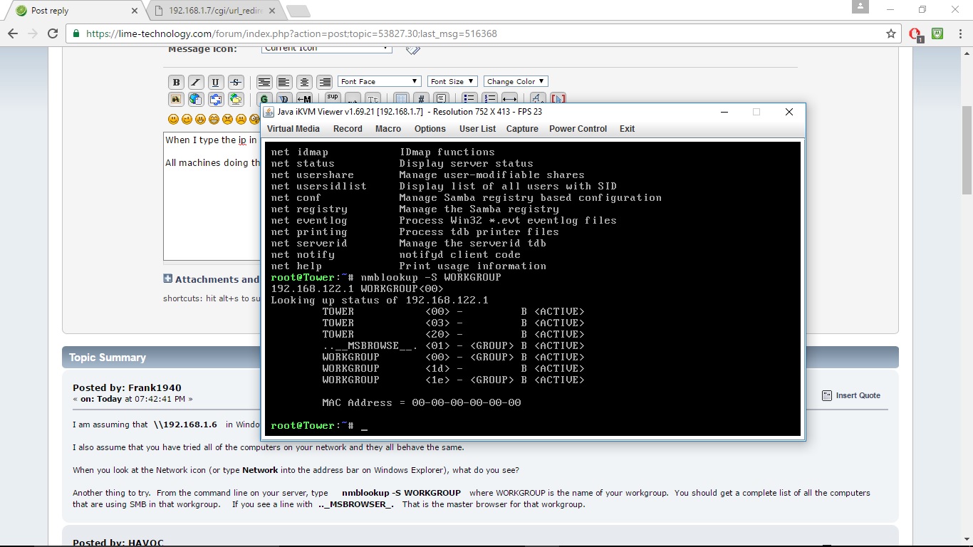

Another thing to try.  From the command line on your server, type    nmblookup -S WORKGROUP  where WORKGROUP is the name of your workgroup.  You should get a complete list of all the computers that are using SMB in that workgroup.    If you see a line with  .._MSBROWSER_.  That is the master browser for that workgroup.

How come the ip is coming up 192.168.122.1? Thats weird right?

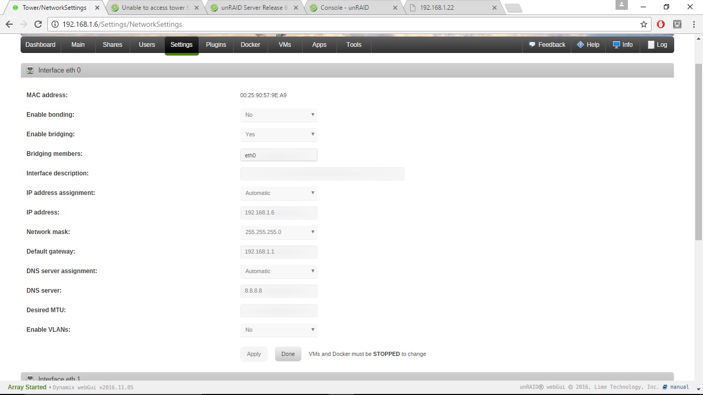

When you see a 192.168.122.1 address, you know you are on the internal virtual bridge, usually virbr0.  You want the external bridge br0, so just select it.  If you don't see it, go to Network settings and turn on bridging.
Bridging is enabled and my docker apps are working.
