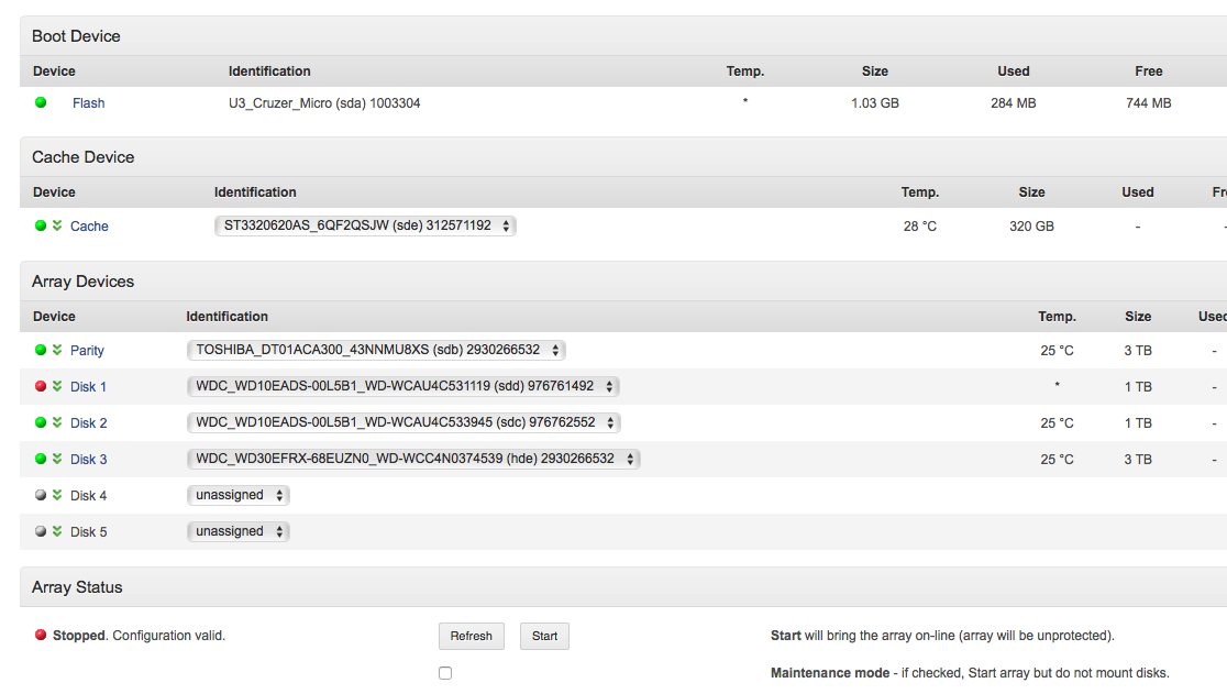

  • 2 months later...
Here are the requested screenshots.  The disk is now totally out of space and has a red dot next to it.
Been a few months!
Those are not the requested screenshots, but they are useful, since it tells us you have a much more serious problem than just a full disk.
Disk1 is disabled. It will have to be rebuilt. Do you have a spare? If not maybe we can rebuild to the same disk, but we would need to see a SMART report from disk1 first. See the stickies at the top of this subforum.
Do you have backups?

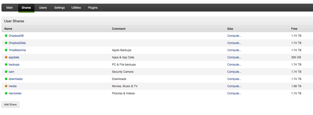

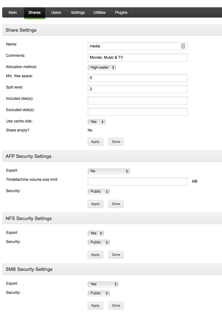

You still haven't posted the share settings details.

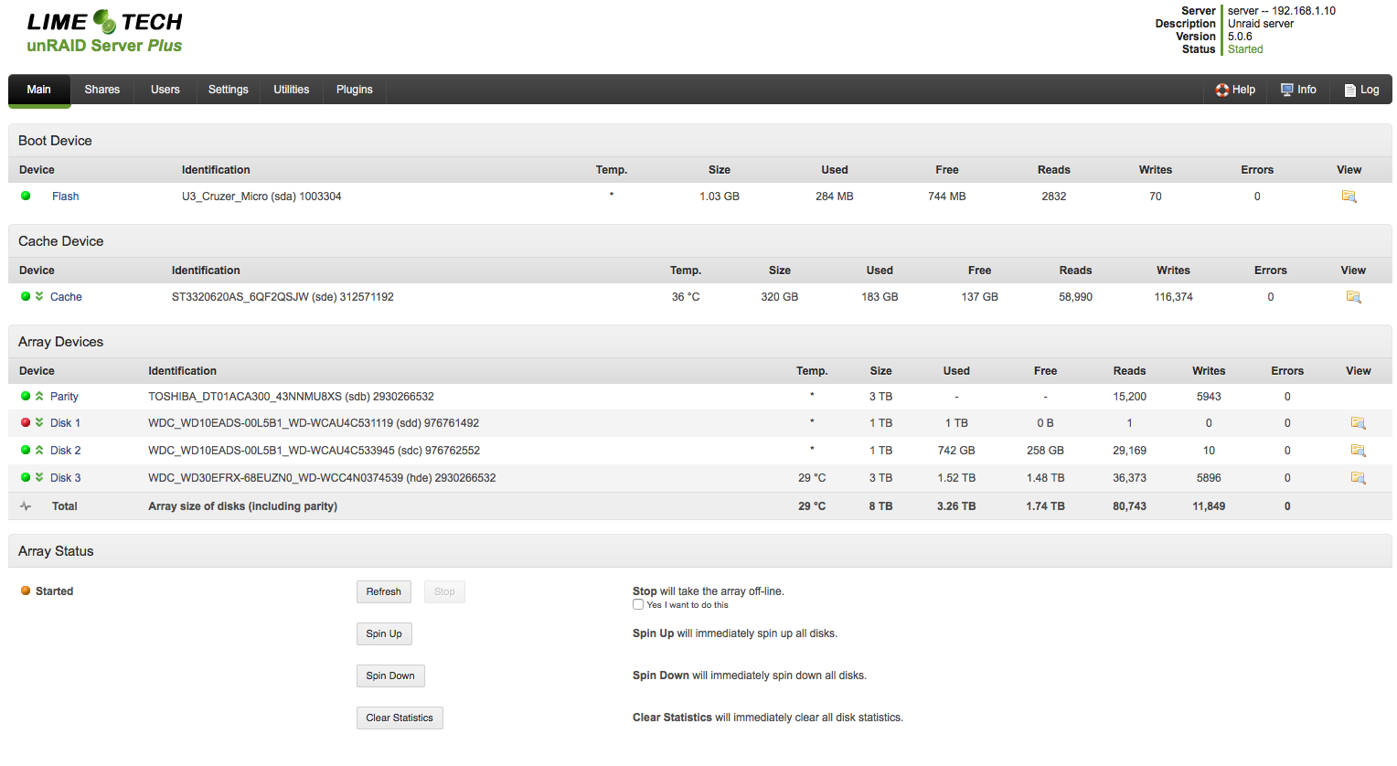

And the graphic of "Main" is cut off on the right so we can't see the current status of the disks -- although we CAN see that Disk 1 has a red ball, which means it's been disabled due to a write error.
Post a new copy of the Main page that shows ALL of the information  (If you need to do 2 screenshots to capture it all just post it in two parts).    ... and post a picture of the share settings for your Movies share.    [On the shares page, click on the name of the share -- e.g. "Movies" -- and post a picture of the next page it displays.]
I suspect you have two problems ...
(1)  Your Movies share most likely is only set to use Disk #1, and that disk is most likely full => this is easily fixed.
(2)  Disk #1 has been disabled, so you need to replace NOW before another disk fails, or you'll lose all of its data.  Right now you can still "see" the data because it's being emulated using all of the other disks to compute the correct data for it (that's what parity allows you to do).
But to confirm those assumptions, you need to post the two graphics I just mentioned.

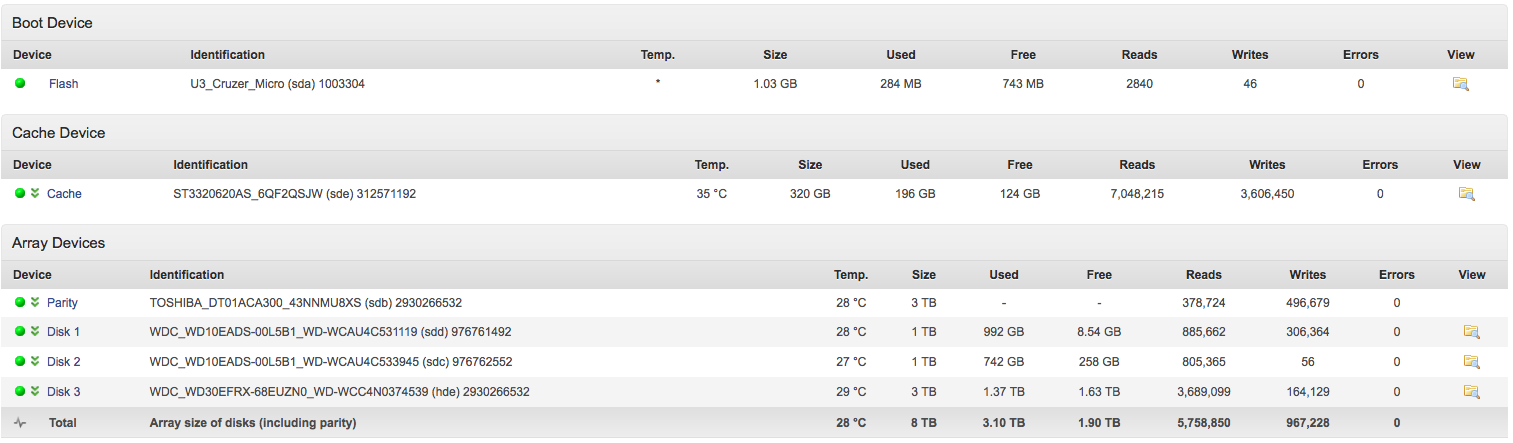

Thank you both for your help (and patience)!  I am attaching the requested screenshots of the full Main screen and the Movies share.

Maybe split level is causing it to keep writing disk1, but we can look at that later.

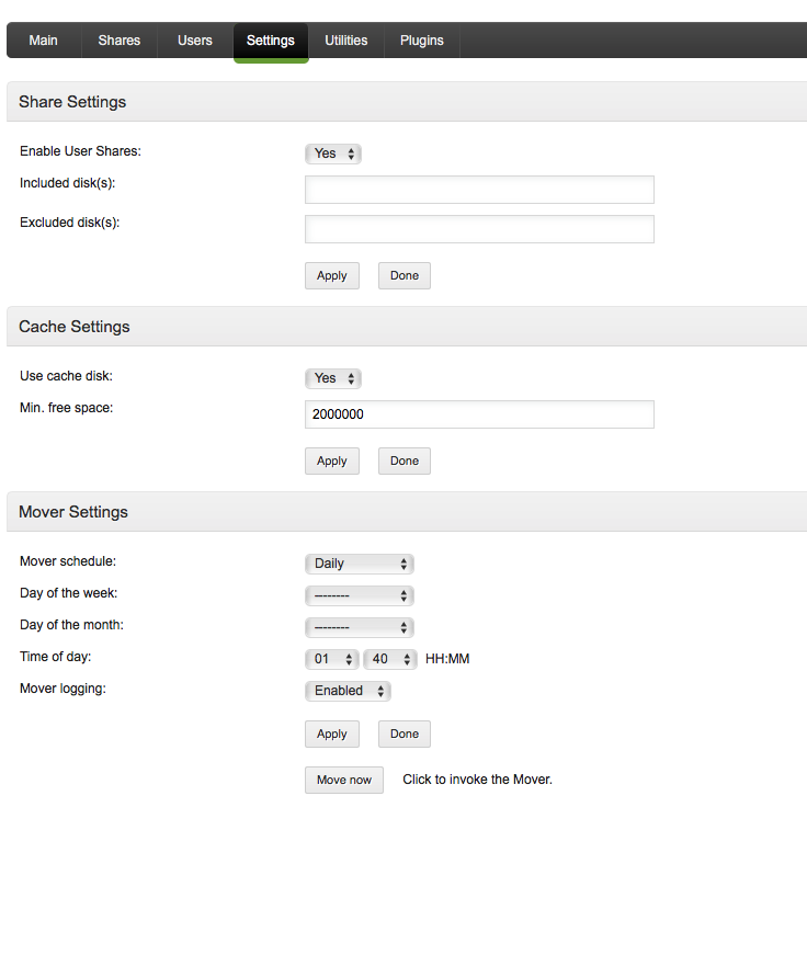

Also post your global share settings => on the Settings page click on Share settings and post the result.  I suspect you may not have all disks included at the global share level.  This is very easy to fix, but first I'd get the disabled disk resolved ...
As trurl noted, your SMART data looks okay, but I would NOT try rebuilding the disk onto itself -- SOMETHING happened that caused it to be disabled; and with no backups I would NOT do anything that would change that disk until you have your data safely "tucked away" -- either on a backup or on a new disk.  That disk also have nearly 60,000 hours of use ... almost 7 years of 24/7 operation ... so it's a good idea to replace it anyway.

Global share settings attached.  I've ordered a new 3TB WD Red drive.  I will get the photos and other irreplaceable files backed up immediately and follow your replacement plan when the new drive arrives.
All of your drives should be useable by the share, as they're not excluded by either the global share settings or the settings for the share.  I suspect you're attempting to copy files to a folder level that your split level prohibits a change of disk for -- so it's simply running out of space.    I'd delete the split level (leave that field blank -- which means split as needed) and confirm that resolves your issue with copying data to the share (it should then use all of your disks as needed).
But the first thing I'd do is get the disabled disk replaced.  Except for copying data from disk #1 to another system to back it up, I wouldn't use the server anymore than you absolutely must until you have replaced the drive.
