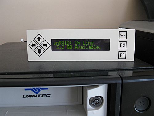

I have a Matrix Orbital M2 display now working on unRAID.
This is a 2x20 display, with keypad.
The way I am writing the display program is macro based.  Each screen is based on a macro.  A macro is a program run from the console prompt that will produce 40 characters of output (2 rows of 20 characters concatenated together).
So anyone can write a macro in any language or shell script (awk, php, java, delphi, perl, ruby, etc.) as long as it can be invoked from a shell script, and it returns EXACTLY 40 characters.... so you will have to pad numbers, etc., to make the output 40 characters.
Macros will be stored in a specified directory on the flash, and a web interface lets you enable/disable them.
The enabled ones will rotate, meaning they display for x-seconds, then the next one, etc., and after all of the ones you have enabled are shown, it loops back to the beginning.
Macros can be conditional.  If the macro output starts with character 254, it will be skipped.  So you can write a macro to check for low disk space, and have it output a single character 254 if disk space is OK, and a full 40 character message if disk space is NOT OK.
I also will implement some way of designating macros as important/errors, which will take precedence over normal screens.
The macros can be used by other flavors of displays too, such as CrystalFonts... all I have to do is change the driver code.
I chose the Matrix Orbital because it has good support, and it has 4 controllable fan headers.... so it will also be used to control fan speeds in unRAID.  This one also has the keypad, so I can put commands on the keypad, such as start/stop the array.

That's what I like about the macro approach.  All you have to do is write a script that prints those characters, in a 40-character string.... and my driver will put it on the display.
Wow, I like the setup that bubbaQ has. A Vacuum display would look cool, requiring no back lighting wither. Back in the days I used to use LCDProc on my Linux box via a Parallel Port connection using a 16x2 Dot Matrix display. I might try and get it to run with my unRAID box. Any links dedicated to this setup? Cheers!
