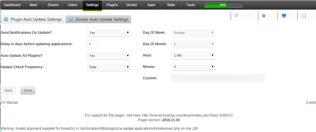

I have this problem as well.
I don't know when it started, but it has been about a couple of weeks-ish.
I do see a
"Warning: Invalid argument supplied for foreach() in /usr/local/emhttp/plugins/ca.update.applications/include/exec.php on line 100"
on the CA Plugin Auto Update Settings page.
I included a screen shot so you can see my options.
Well, you found a bug in there that I've got to figure out why its showing up  (best guess is that you have docker enabled, but don't have any containers installed)
But to fix the cron email, change any setting on the plugin page (ie: up the time by one minute) and apply
I think doing the update fixed the error message on the setting screen.  Also I have a 13 dockers (11 running).
