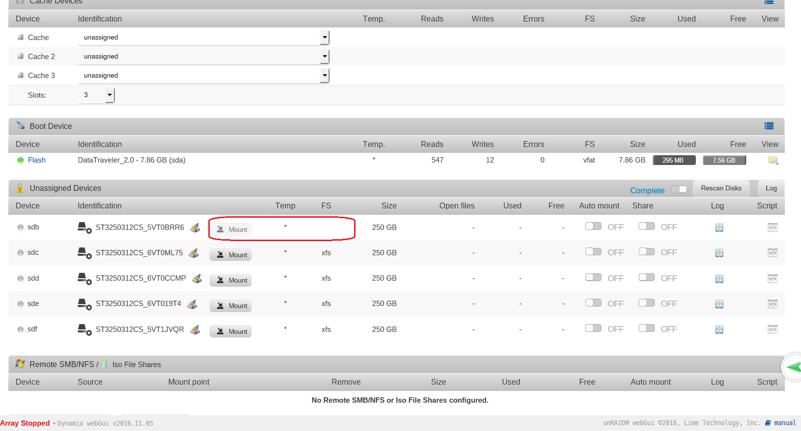

Safer yet is to use the unassigned devices plugin, with all disks unassigned all but parity should have the mount option and the filesystem shown, the one without it is your parity.

Yeah, got the idea last time I needed to do that, with the array stopped it should look like the example below.
Managed to grab these before upgrade..

Important one is parity, if you're sure it's still the same you can use that, if you assign a data disk as parity you'll lose data.

This one?

Yes
