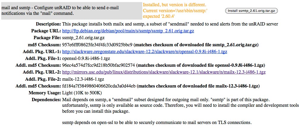

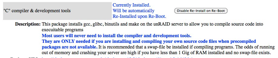

Hi Joe,
I have been using unmenu successfully, thanks again. I did not have time to test the mail package earlier so I wanted to give it a try. I cannot manage to install it. I have installed C compiler and development tools, and then the mail and ssmtp. However, everytime when I try to install the mail, I get: "Installed but version is different" notice, and the button beside still reads "install sstmp_2.61.orig.tar.gz" - what am I doing wrong?
- when I test the mail by typing: echo "this is a a test" | mail -s "testing mail" root, I get: /usr/sbin/sendmail: No such file or directory
Also I get this after trying to install:
Verifying package openssl-0.9.8i-i486-1.tgz.
Installing package openssl-0.9.8i-i486-1.tgz:
PACKAGE DESCRIPTION:
# openssl (Secure Sockets Layer toolkit)
# The OpenSSL certificate management tool and the shared libraries that
# provide various encryption and decryption algorithms and protocols.
# This product includes software developed by the OpenSSL Project for
# use in the OpenSSL Toolkit (http://www.openssl.org).  This product
# includes cryptographic software written by Eric Young
# ([email protected]).  This product includes software written by Tim
# Hudson ([email protected]).
Executing install script for openssl-0.9.8i-i486-1.tgz.
Package openssl-0.9.8i-i486-1.tgz installed.
loading cache ./config.cache
checking for gcc... gcc
checking whether the C compiler (gcc  ) works... no
configure: error: installation or configuration problem: C compiler cannot create executables.
sed: can't read Makefile: No such file or directory
/boot/packages/ssmtp_2.61.orig.tar.gz.manual_install: line 22: make: command not found
cp: cannot stat `ssmtp-2.61/ssmtp': No such file or directory
ln: accessing `/usr/sbin/ssmtp': No such file or directory
ln: accessing `/usr/bin/sendmail': No such file or directory
Verifying package mailx-12.3-i486-1.tgz.
Installing package mailx-12.3-i486-1.tgz:
# mailx (a simple mail client)
# Mailx is derived from Berkeley Mail and is intended provide the
# functionality of the POSIX mailx command with additional support
# for MIME, IMAP, POP3, SMTP, and S/MIME. It provides enhanced
# features for interactive use, such as caching and disconnected
# operation for IMAP, message threading, scoring, and filtering.
# It is also usable as a mail batch language, both for sending
# and receiving mail.
# The maintainer and primary developer of mailx is Gunnar Ritter.
Executing install script for mailx-12.3-i486-1.tgz.
Package mailx-12.3-i486-1.tgz installed.
Please find attached my screencapture showing the wrong version in orange text.
Hi Joe,
The error says it pretty plainly.  You do not have the "C" compiler and tools installed.
Yes I understand, but does not it install via unMENU package manager like it says "currently installed, will be automatically re-installed" in the attached file. Or should I search for it and install manually? I would be happy if you could kindly give me some hints. Thanks.
First, make sure your version of unmenu is up to date.  Lots of tiny fixes in the past week.
You can use the button on the user-scripts page.  If it does not exist, then for sure you are not up to date.
Then, you can type at the command prompt.
rm /usr/bin/cc
and then re-install the "C" compiler. then install the mail program.
Thank you, solved. I had to reinstall the most recent version of unMENU as well as the C compiler. Now all are installed. iStat, which is new, is cool :)
