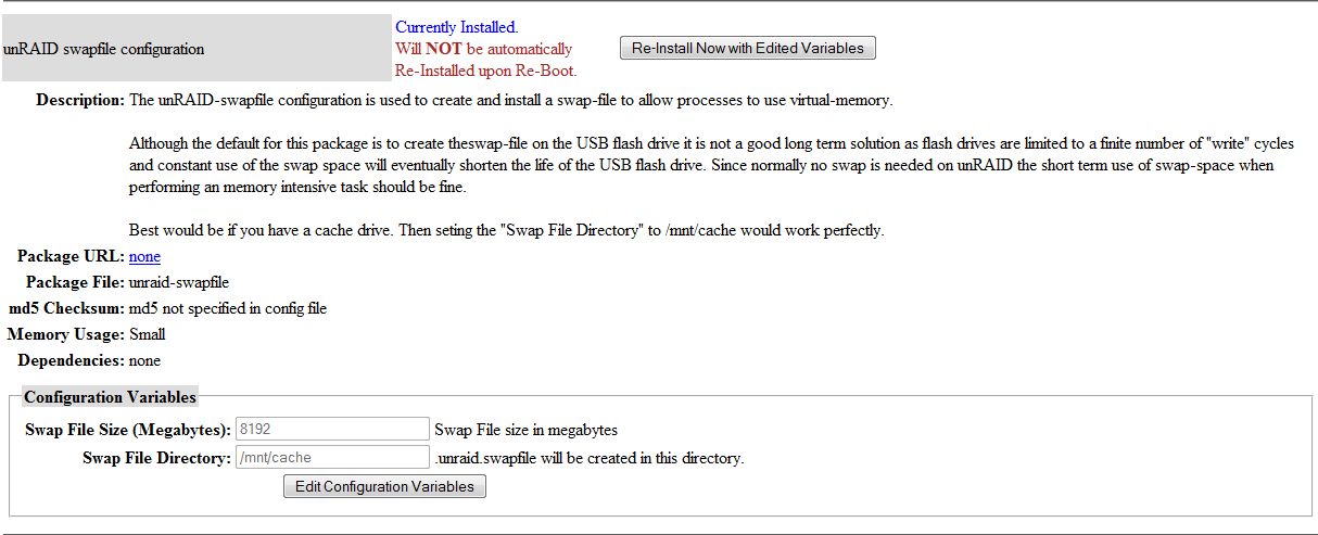

I downloaded the newest unraid-swap.conf.
I tried editing the configuration values once and then saved them.  When 'installing' the swap file it went back to default values.
I didn't want to reboot again right away ...
When I re-edited the configuration variables and I set them to 8192 MB (the size of installed memory) and set the drive to /mnt/cache as suggested ...
and clicked on the "Re-Install now with edited variables" the reponse I get is ...

and when I check the settings after this it says the swap file is size:128MB and is mounted on directory:/boot
I tried clicking re-intstall on reboot (or something close) and re-edited the values, setting them to 8192MB and the directory to /mnt/cache
upon rebooting the values are once again size:128MB and directory:/boot and it says package not yet installed for the swap file settings
am I trying to go too big on the swap file?

It looks like the swap file is busy.  You'll need to disable swap first, then you can re-install it.
You'll also need to disable swap in order to stop the server, otherwise the cache disk will be busy and unable to be un-mounted.
To disable it use the button on the user-scripts page or type:
/sbin/swapoff -a -v
rm /var/log/unRAID-swapfile

After you edit the config values and save the edited value you must them press the re-install with new values button.  Otherwise, nothing gets installed with the edited values.
Joe L.
