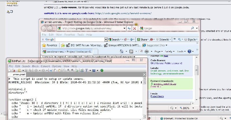

The new version isn't installing for me...
I must be doing something wrong.  I downloaded from here: http://code.google.com/p/unraid-unmenu/
It contains a single unmenu_install file.  I put that in my unmenu folder and ran it like: unmenu_install -u
It finished.  I killed and restarted uu.  Open a browser and in the About page it still says version 1.2.
So I killed it again.  renamed the unmenu folder and created a new unmenu folder.  Ran unmenu_install -i -d /boot/umenu
There isn't any /boot/unmenu/uu file.
root@Queeg:/boot/unmenu# ls
apcupsd-unmenu-package.conf*  pciutils-unmenu-package.conf*
bwm-ng-unmenu-package.conf*    php-unmenu-package.conf*
cxxlibs-unmenu-package.conf*  powerdown_ctlaltdel-unmenu-package.conf*
file-unmenu-package.conf*      proftp-unmenu-package.conf*
lighttpd-unmenu-package.conf*  rsync-unmenu-package.conf*
lsof-unmenu-package.conf*      smartctl-unmenu-package.conf*
mysql-unmenu-package.conf*    unmenu_install*
openssh-unmenu-package.conf*  unrar-unmenu-package.conf*
openssl-unmenu-package.conf*  zip-unmenu-package.conf*
I never said to kill "uu"
I said to use
killall awk
What happens when you run unmenu_install -u  ?
Do you see a set of about 80 files being downloaded?
You said you installed it by running
yet you looked for the files in /boot/unmenu
umenu != unmenu
I did exactly as described below.  I tried the unmenu_install -u first.  Yes lots of stuff flashed as it was running.  After rebooting the About page still said version 1.2.  Then I tried doing a clean install by making an empty unmenu folder and trying it again with the (as described below) correct parameters.  Yes I used killall awk (as described below).  Yes I read your instructions.
There isn't any /boot/unmenu/uu file.   This is after running "unmenu_install -i -d /boot/unmenu " with an empty /boot/unmenu folder.

So Joe, if no /boot/unmenu/uu shows up I'm wondering if a clean install isn't working?  I tried very hard to follow your install guidelines.
OK, I just did the following in "blue" with the resulting output in brown to double-check.   The text in RED are my comments describing what I am doing.
Everything worked as expected.
Please do the same and we'll compare output

root@Tower:/boot/unmenu# ./uu   <-- I invoke "uu"
The new unMENU is running, and it shows version 1.3
Let's see where you differ.
Joe L.
Not the same unmenu_install.  I'm getting it from where your post says to...
The difference between my version and yours was the addition of a test to ensure your name-server and network gateway were configured and a test to ensure you have a version of unRAID with "wget" installed.  Other than that, they are the same.
I just updated google.code with the latest version with those tests included.  You can download it and see if they detect the reason for your difficulties.
You can get it here: http://code.google.com/p/unraid-unmenu/
Joe L.
It worked finally but still with a bump or two.
I got the latest version.  I copied it to the flash drive config folder.  Then in telnet I copied it to the /boot folder.  Doing the head showed the older file.  So I checked the downloaded version on my Win machine.  It was the later copy.  I decided to remove the /boot/unmenu_install and /boot/config/unmenu_install and copied it again.  This time the head showed the newer version.  For some reason the copy or cp wasn't overwriting the existing file.
And does unmenu now show version 1.3 ? ? ?
Joe L.
Yes.  What relief.  I really rely on unMenu all the time.  It's a little like being blind without it.   You should set up a donation page for it.
