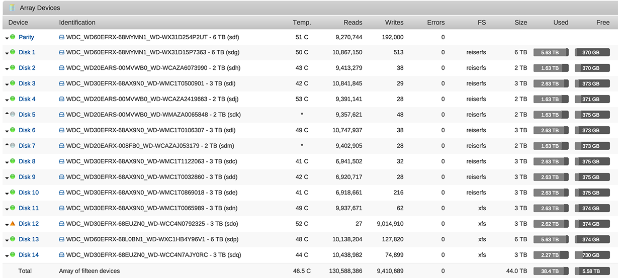

tjiddy, if you look at Main - Array Devices, you should see a lot of writes to the disk that is being rebuilt, and a lot of reads from all other disks.
Yep, it looks like it's rebuilding disk 12
