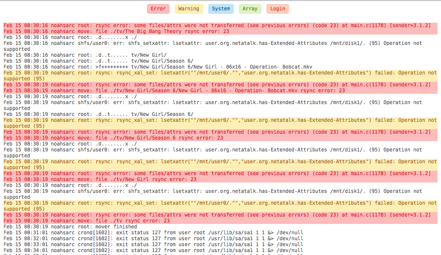

Hello, I'm also having what I believe is the same exact problem and are getting the same errors.  It all started after I upgraded to 6.3.1.  I have started another topic yesterday but got no responses so if you don't mind I will also post my diagnostics in the event our issues are related and additional information can shed light on the cause.

noahsarc-diagnostics-20170215-0829.zip

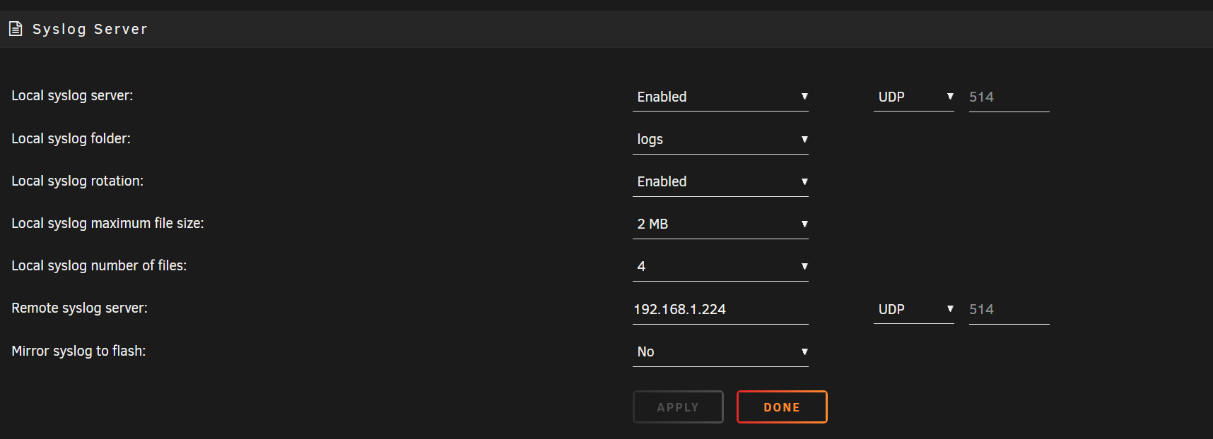

i have this same issue currently and have found that a i have 2 syslogs and one of them is 300g+ in size taking up all of the 500g cache pool space.  do i need this file? what is it, can i move it, delete it or replace it w/ the smaller one etc?  i'm new and just fixed a few other things from the other days hdds being taken offline out of nowhere and i'm now trying to make sure the cache has enough space to function.  or do  i need a larger cache pool?
thank you for the help in advance.
You must have setup syslog server and told it to log there since otherwise syslog is in RAM and doesn't survive reboot.

So did you?
10 minutes ago, sirhotness said:
can i delete it?
Yes. Is it still enabled?
10 minutes ago, trurl said:
So did you?

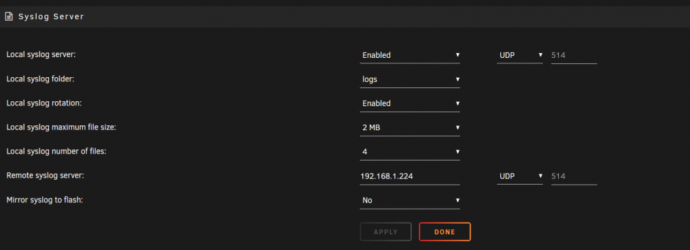

yes its still enabled on my end.  attached a screenshot for you.
