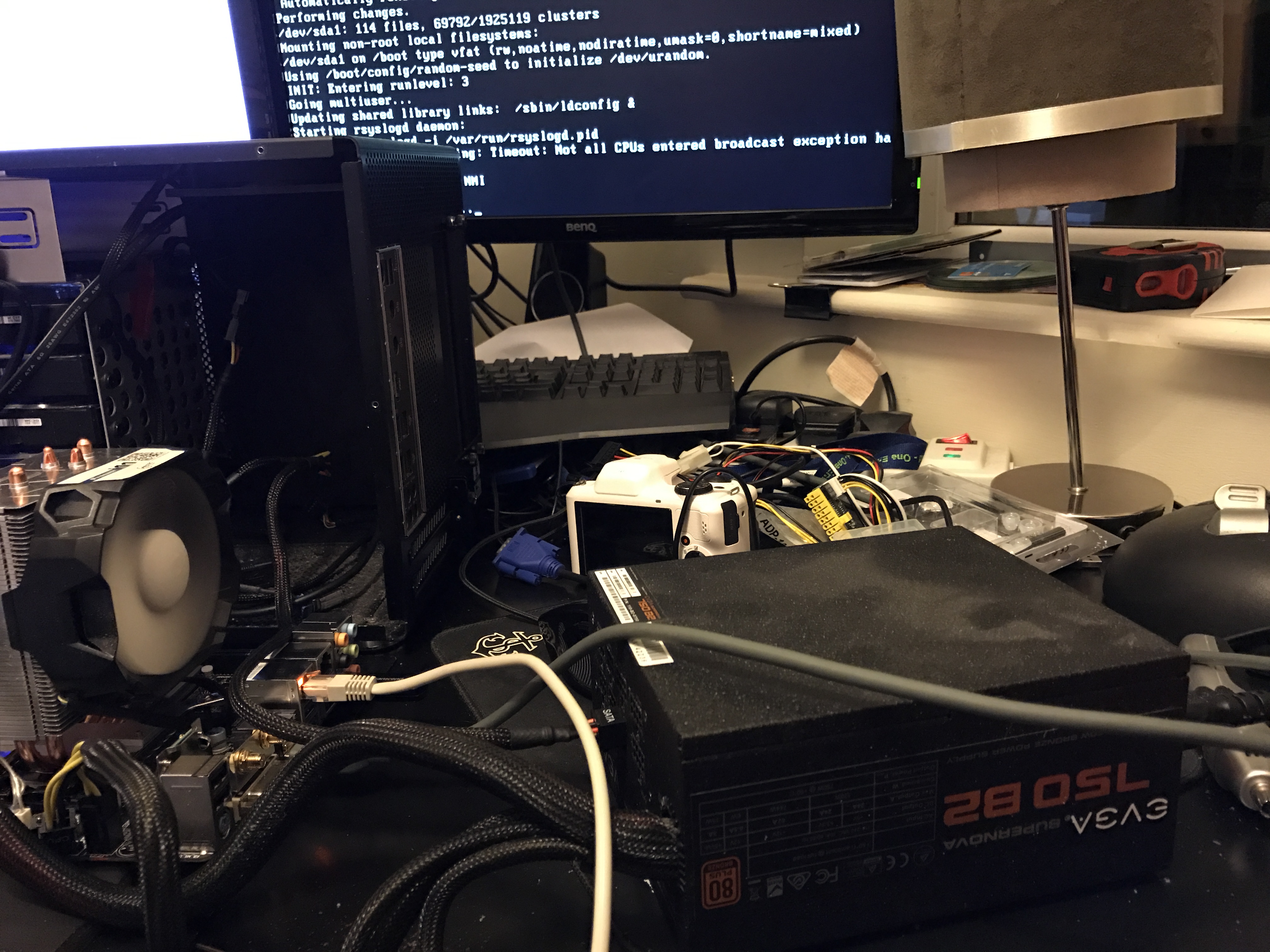

I'm willing to concede that my PSU may be cutting it a bit fine. I pulled the EVGA Supernova 750 W PSU from my gaming rig. It's good for 62A on the 12V rail. I booted 6.3.2 and no mce errors in the log. I did more research into the PicoPSU, it seems it just passes 12V straight from the external AC-DC brick. The brick being 120W, obviously can only do 10A which is a lot closer to the specs on the WD Red datasheet (although still within measured power consumption of 80W). Anyway, I'm going to order a 150W brick, and in time will reduce my drive count to 4. I've also ordered a PCW case fan to bring my drive temps down and I'll reconfigure the drive layout in the case so there is a gap in the middle.
However... I still get a kernel panic on 6.3.2 within a minute of booting. The second time it didn't even get to the login prompt (see attached) . This is taking my brand new 6.2.4 build with 2 Dockers, and a handful of plugins and running an Update from the Plugins tab. 6.2.4 runs like a champ - I've completed 2 Parity Checks and spent the evening watching Plex while it was doing a check. Is it reasonable now to assume there is a bug in 6.3.2?
