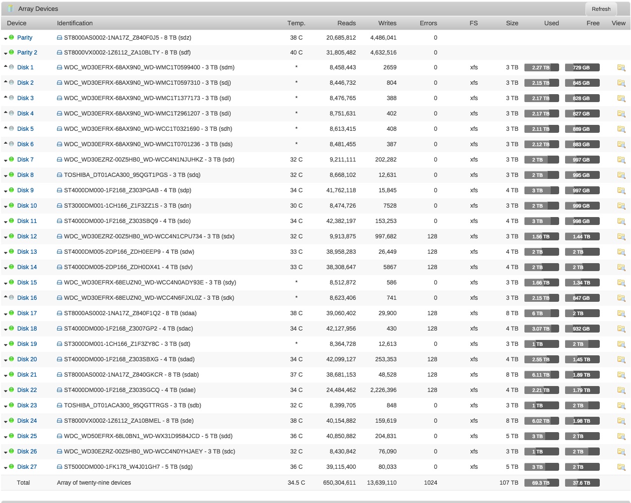

Came into my office this morning to see all the lights blinking on my Supermicro sever and I thought, 'here we go again, it must of rebooted' but actually it hadn't however it was running a parity check. Further investigation reveals that for some reason multiple disk errors were reported causing the server to do a parity check. Right now, I've got 8 disks showing exactly 128 errors and the parity check is almost at 28%. No drives are offline, no red x's, very odd. I've attached diagnostics. Interestingly enough, the parity check has found and corrected 128 sync errors so far.

Actually it turns out this is a regularly scheduled parity check, however its still very odd that multiple disks are reporting errors and they are all reporting the same amount of error as well.

Still looking for some advice on what to do about this. Parity check it taking way longer than normal for some reason, its reading at anywhere from 7MB/s to 4MB/s and at this rate says it won't finish for four days or more. Something is not right.

Parity check speed is back to normal, no change in the number of errors its 'allegedly' found so far of 128
Looks like there was a timeout error with the controller, hopefully it was a one time thing, just in case check that the controller is well seated and run another parity check once this one finishes.
What about the errors being reported on the disks? Will they just go away after a reboot? Ughh parity checks take like a day and a half. Are these reported errors real? I don't think they are.

Where do you see in the log that it was a controller timeout, or is that just what it looks like? How does that even happen?
Feb 26 00:03:05 Tower kernel: sd 1:0:21:0: timing out command, waited 180s
Feb 26 00:03:12 Tower kernel: sd 1:0:22:0: timing out command, waited 180s
It's the same on all disks so it makes sense that it was the controller that timed out.
So would you recommend letting this parity check finish even though the errors its reporting are probably false. And then running another one after a reboot?
If it's close to finishing yes, if not reboot and start another one.
