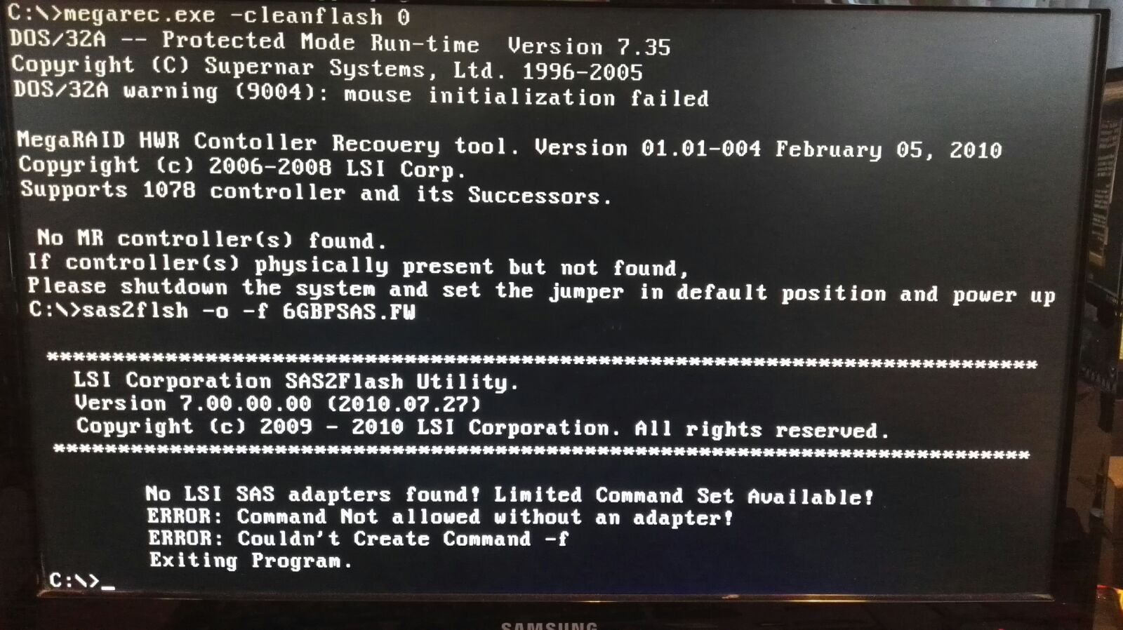

I bought two H310 and wanted to flash one by one using this tutorial: https://techmattr.wordpress.com/2016/04/11/updated-sas-hba-crossflashing-or-flashing-to-it-mode-dell-perc-h200-and-h310/
I managed to get the SAS address, but shortly after got the "Failed to initialize PAL. Exiting program." Error. I then tried to get it done via the efi shell but then I get this error: "No LSI SAS adapters found!"
Things I've done:
megacli.exe -AdpAllInfo -aAll -page 20 -> got my SAS address
megarec.exe -writesbr 0 sbrempty.bin -> got the needed error
megarec.exe -cleanflash 0 -> rebooted after
sas2flsh.exe -o -f 6GBPSAS.fw -> PAL error
sas2flash.efi -o -f 6GBPSAS.FW -> NO LSI SAS...
What should I try now?

I cant carry on with that route, as my H310 dont get recognized anymore...
Any idea how to get them back?
I wonder why the first megarec command failed and why the subsequent one completed !?!?
Is the file sbrempty.bin the right one? Is it present?
What is the exact fault message? Can you try running it once again?
According to Maglin, only sas2flsh should quit with the PAL error!
That is the point where you switch to EFI shell and do the rest with the sas2flash.efi. (note, spelling is not sas2flsh)
Edit:
From you second post I get,
neither megarec nor sas2flsh recognize your card anymore. O.o
Is this the same after rebooting? If you issue the commands straight after the megarec -cleanflash, then it's normal.
After a reboot the adapter should be back though.
