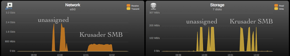

Question: why does transferring data via the remote connection using smb in krusader use less bandwidth than using unassigned devices remote share mount in krusader? see image.

@1812 I have no idea!
