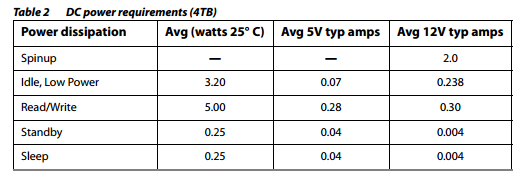

It looks like the ST4000DM000 HDD's that I already have are 5900RPM. So I currently have 7 of those.

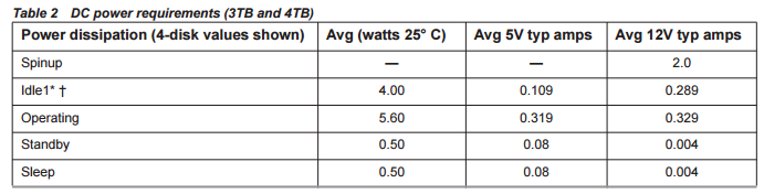

I can find the ST4000DM005 (same model but newer?) for really cheap, £97. I believe that's the same, 5900RPM (it's actually difficult finding this information on Seagates websites, I'm having to use online shop listings so correct me if I'm wrong there).
The power ratings for the ST4000DM000 are:
And for the ST4000DM005:
Most important info is the spin up max current, e.g., my WD greens require 1.75A max on the 12v rail for spin-up, most 7200rpm disks require 2.5A, and adding that up with 20 disks makes a lot of difference.
Yeah, I noticed that the above information states 'average 12v typ amps' rather than maximum.
They are both 5900 RPM from what I can see though.
