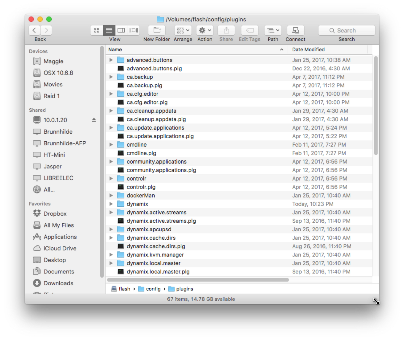

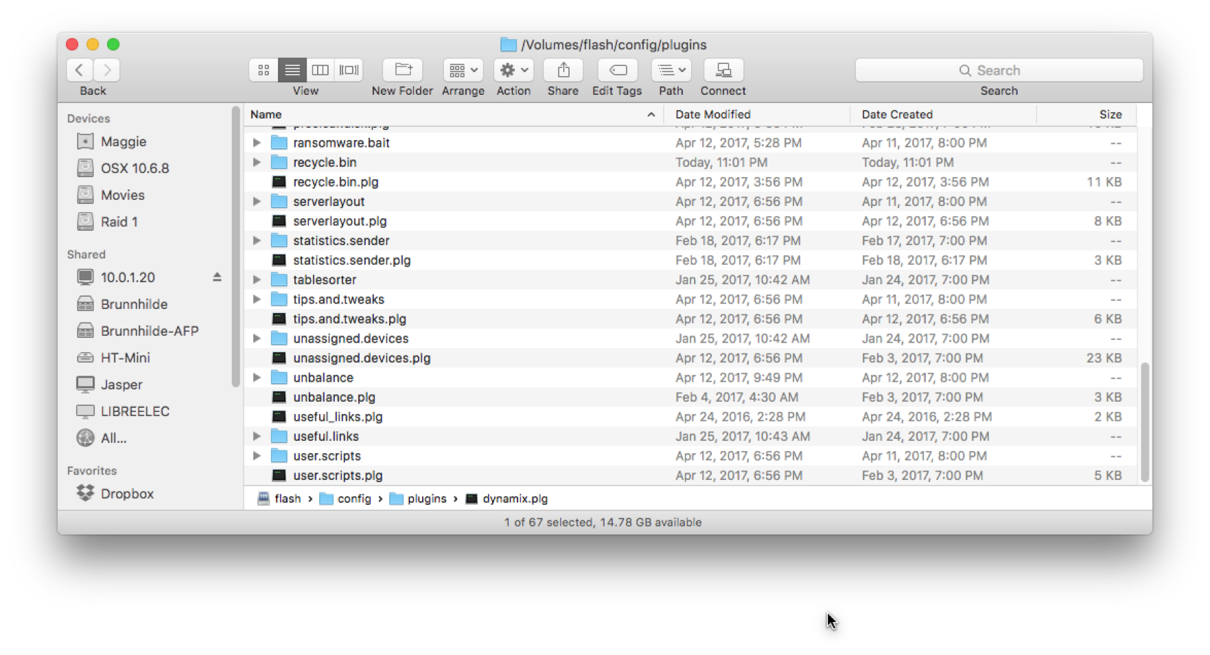

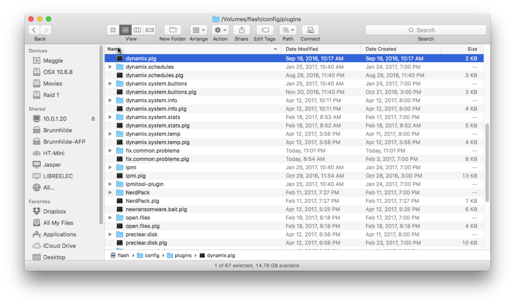

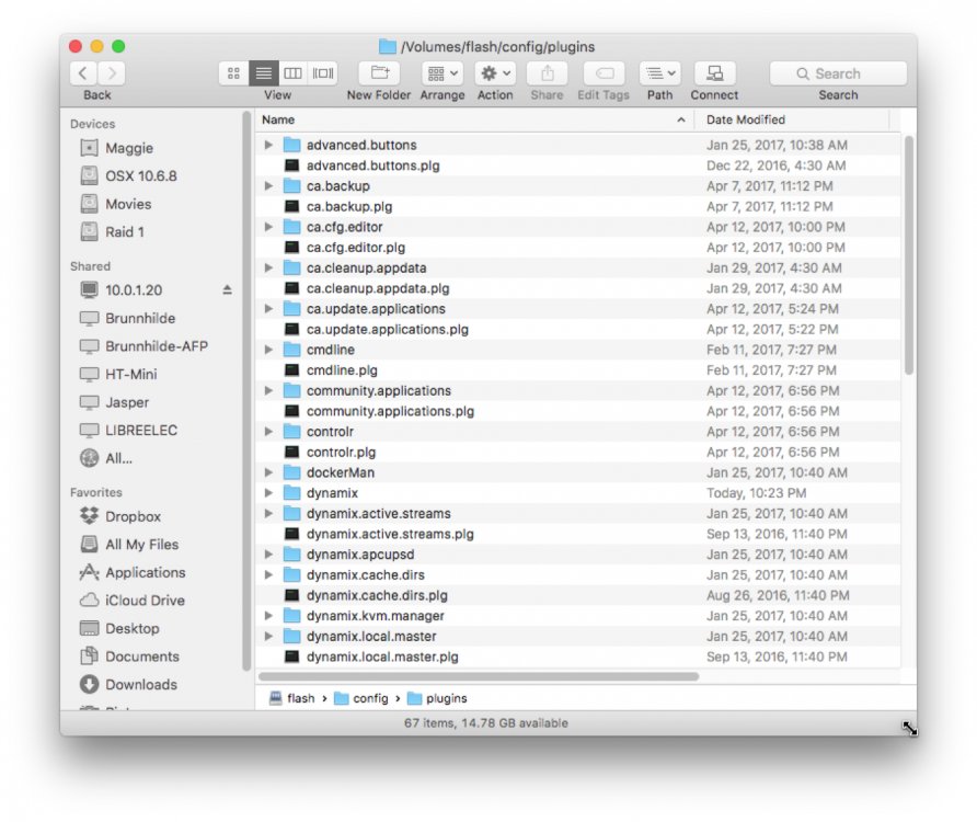

This is just a shot in the dark but maybe someone might see something in the config folder that shouldn't be there? Otherwise I may just have to reconfigure from a new install.
Edited by wgstarks
I've tried deleting every plugin and docker and still getting the error. No idea what to try next. Is this error really a concern?
