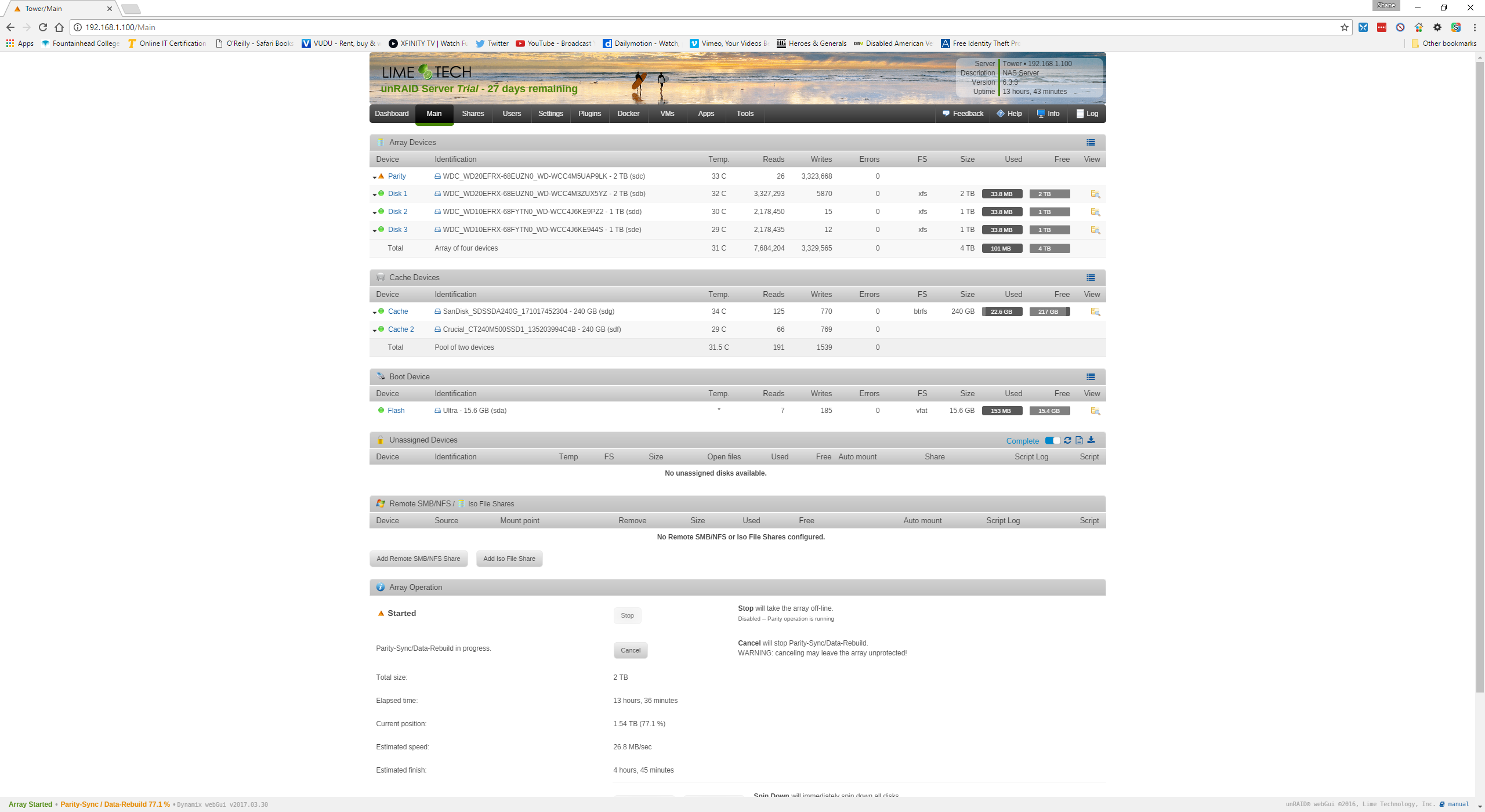

After setting my drives up and setting one drive to parity it went through and formatted the data drives to XFS and started the process of Parity-Sync/Data-Rebuild for the 2TB drive I set as the parity drive, I get Parity Status = Parity is invalid with the amber icon. None of the drives are new, but i've never had a issue with any of them. Was running 2012 r2 Essentials with storage spaces.
Is it showing that way because it's a first time setup?
tower-diagnostics-20170422-0120.zip

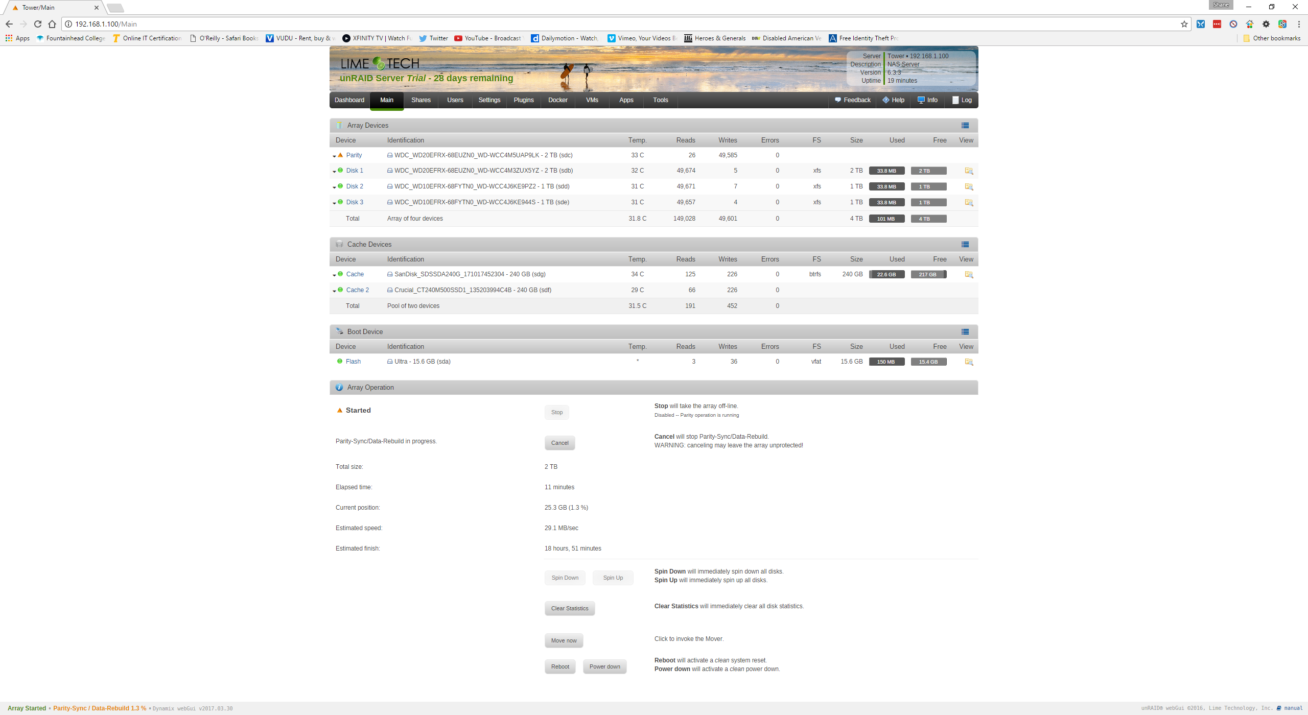

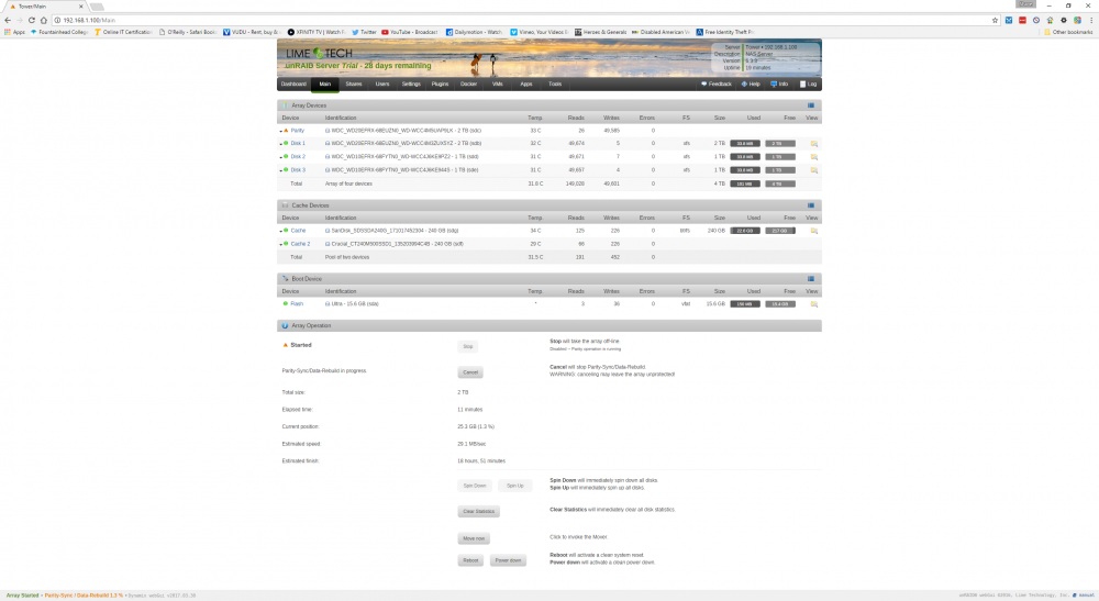

How long does this process take for the Parity-Sync/Data-Rebuild in progress on a new setup? Been running for 13 hours, 7 minutes. And has Estimated finish:    5 hours, 14 minutes left.
Server is a HP ProLiant ML110 G7, something maybe interfering with speed, maybe irq setting or something? Bought this machine for $110, its i3 2100 with 8GB Ram.

Something is not right, it should be about 6 or 7 hours with those disks.
Are you trying to write to the array while it is building parity? That will slow things down.
