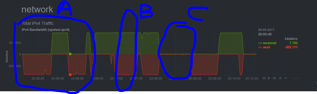

System makes te following crap:
Why the copying is not going like in "B" area, but rather like in "A" area -> read from one interface than write to the second one...
And what is the delay in the "C" area.
This whole situation drops the copying speed to average 20-30  MB/s, wich is totally inacceptable whereas both of the EMC NAS Arrays can go well beyond 100 MB/s ++

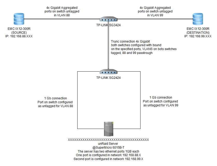

I both cases it is the same configuration with the "copier" in the middle" - so the copying is THROUGH
Let me graph it :)
If in place of XXXXXXXXXXXXXXXXXXXXXXXXXX is the unraid server (as on the picture) the transfer rate is at top 30 MB/s
If in place of XXXXXXXXXXXXXXXXXXXXXXXXXX is a windows machine, the transfer rate is 50 MB/s
Altrough i would expect it to be near full 1GBit....
Am i doing something wrong ?
