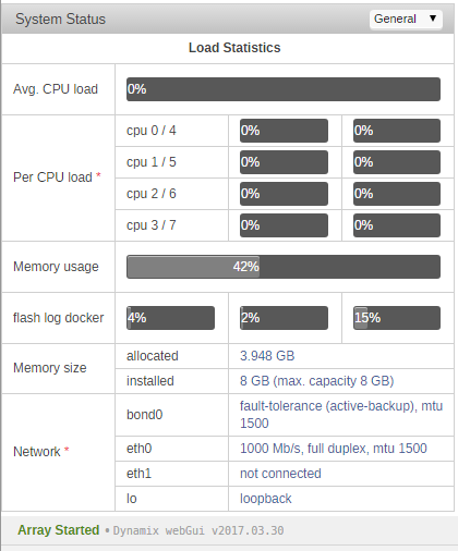

Hello there. I recently transferred an Unraid deployment from a much more powerful gaming PC to a secondary desktop. The transfer went really well, but now I'm having an issue to where my Unraid server is only showing half of my memory as allocated. I've attached my diagnostics file for reference if anyone would take a look.

What's wrong?  You're currently using 3.948GB of your 8GB memory
So at first I thought the same thing, but actually unraid is only allowing me to utilize 3.948GB of memory.

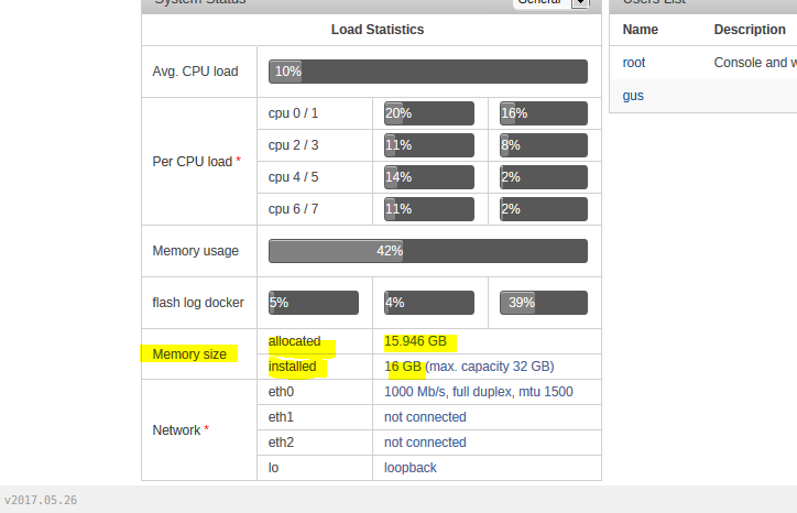

hi everyone,
just wanted to post an update to this post.
the problem is solved now.
basically i was following what ASROCK forums were telling me to do by pairing my 2 x 8GB sticks by slot.
and they were strongly recommending to pair them by slots of the same color - especially white.
i decided after testing both sticks one by one, to pair them one on the white slot and another one on blue slot of the MB.
all is back perfect now.
thanks everyone for your support on this.
