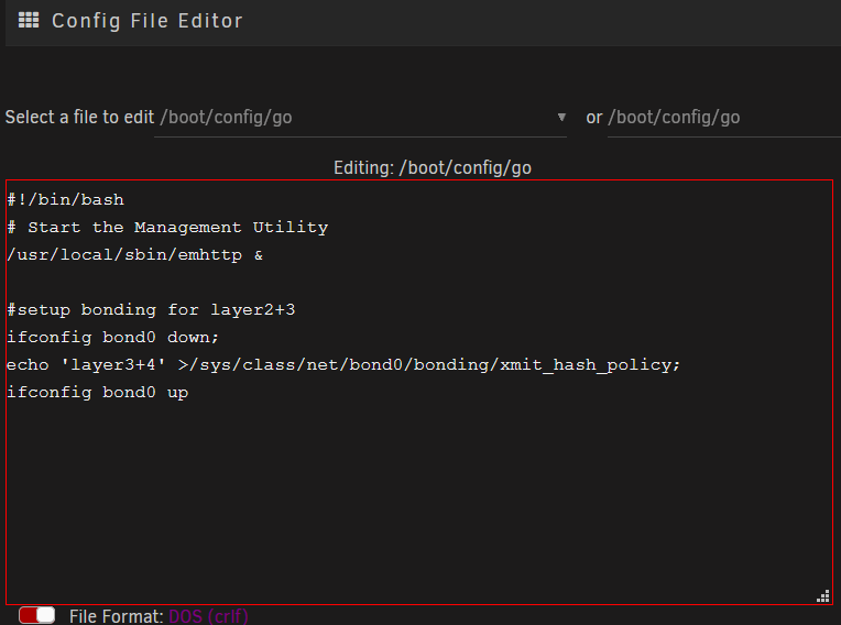

July 21, 20206 yr @klamath @ken-ji Should it look like this? Thanks in advance Edited July 21, 20206 yr by L0rdRaiden
July 23, 20206 yr On 7/22/2020 at 2:26 AM, L0rdRaiden said: @klamath @ken-ji Should it look like this? Thanks in advance Unless you absolutely know what you are doing, emhttp is usually last as that will start the array and other related services. you are in effect quickly restarting the network as containers and vms powerup (though in practice, the array is still mounting at this point)
