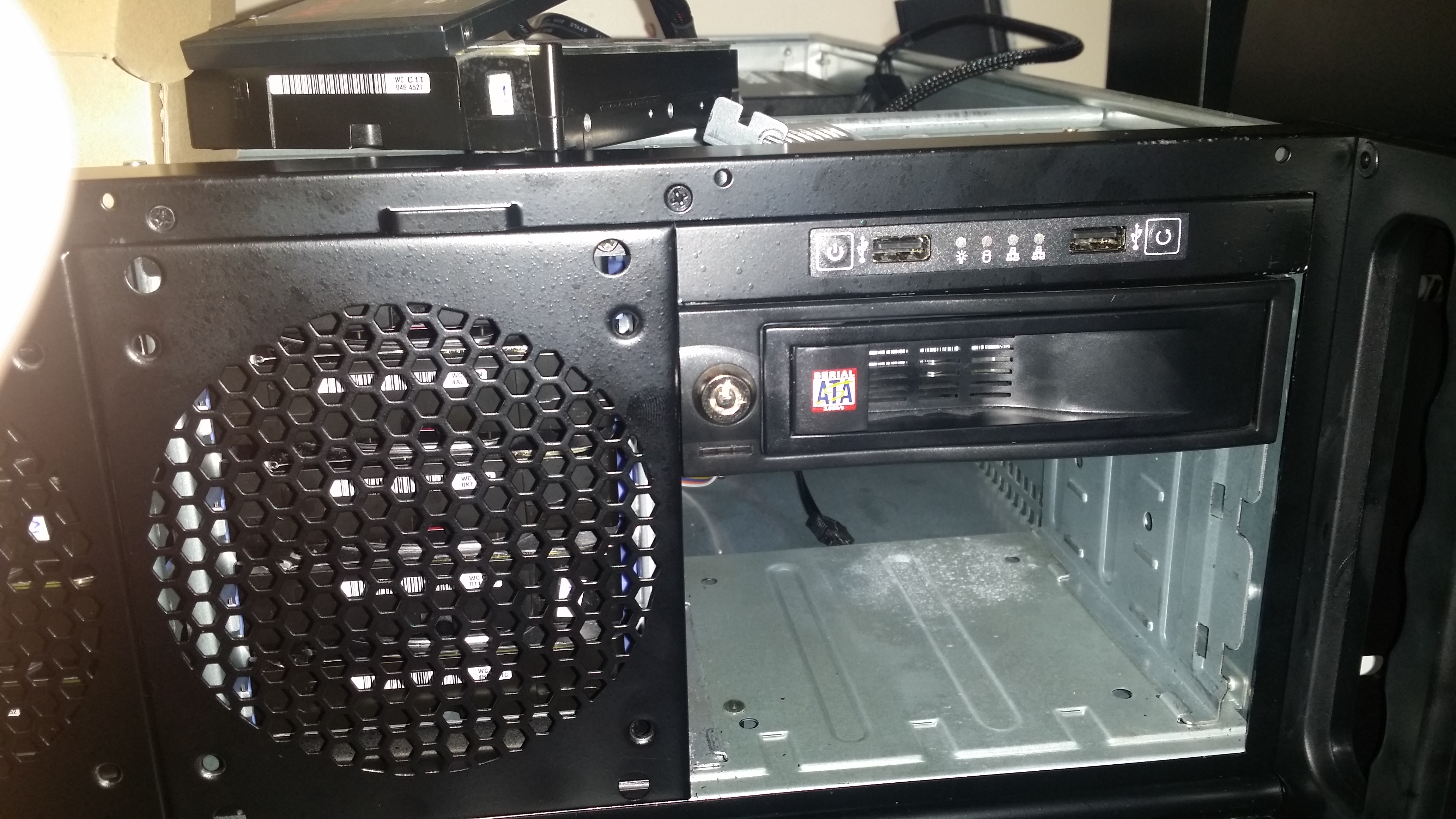

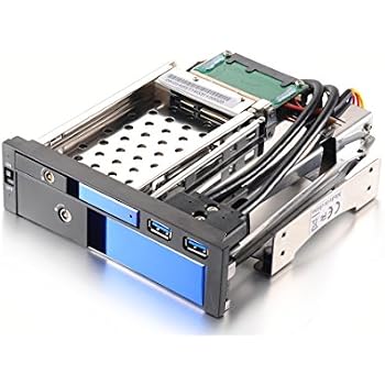

I decided upon using the single hotswap from startech i had lying around, for the top alot as pictured. Also ordered one of these for the lower slot.
Dshot 3.5" + 2.5"
It will do to finish the job. Maybe i should do a review of the case i used.
