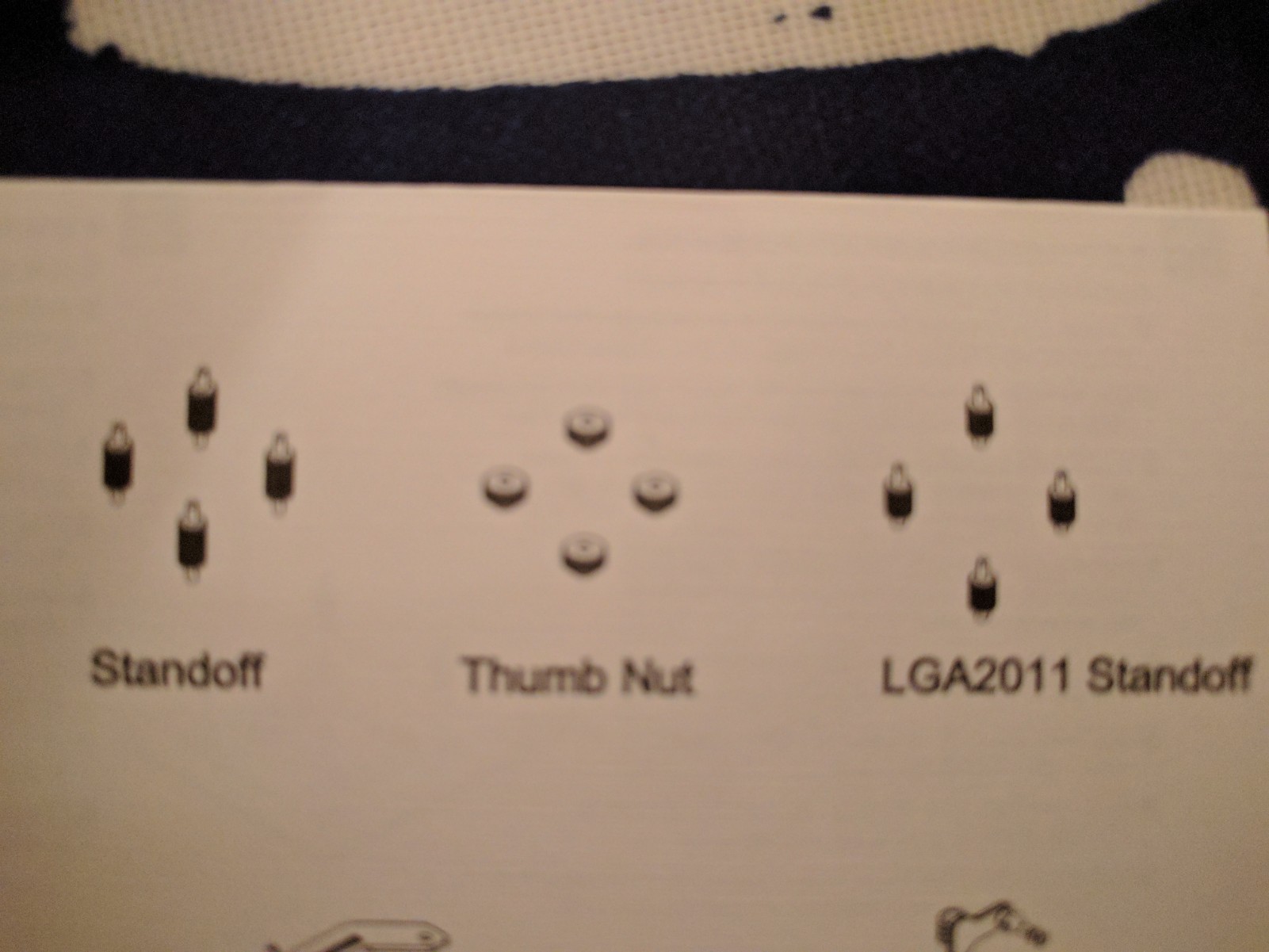

Installing a heatsink for my 2011v3 Xeon E5 into my Asus X99-WS board.
The heatsink is is a Silverstone SST-AR01 , which I bought because OCUK specifically lists socket 2011v3 as being compatible (whereas the Evo 212 had conflicting information)
It comes with two sets of standoffs - one set for when you use the rear bracket, and one (smaller) set specifically for screwing into the existing lga2011 screw holes.
Only the smaller ones fit, so there doesn't seem to be any room for confusion there.
I then install the mounting brackets across the standoffs. Again, these only go on one way, and I screw them down with the thumb screws.
I then pop on the heatsink, and thread the cross-bar through and onto the mounting brackets.

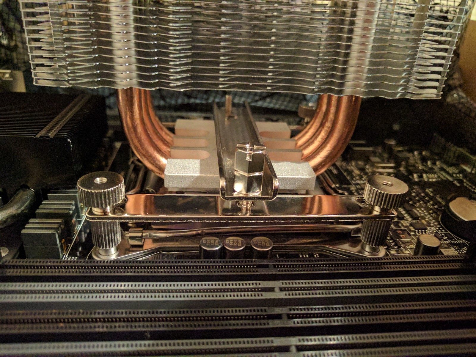

There are then two nuts for screwing the cross bar onto the brackets. And this is where I have a problem.
There's about 4mm of additional clearance between the mounting bracket and the cross-bar.
Is this right? Should it not be fairly flush?
The other standoffs are taller, but won't thread into the screw-holes.

Looks to me like that clearance is what gives you the adjustable clamping force. The tighter you screw it, the harder it squeezes down to the CPU. Are you sure it's seated completely flat? It looks a little offset or angled in your photo. Make sure it's not interfering with any of the motherboard components or CPU socket pieces.

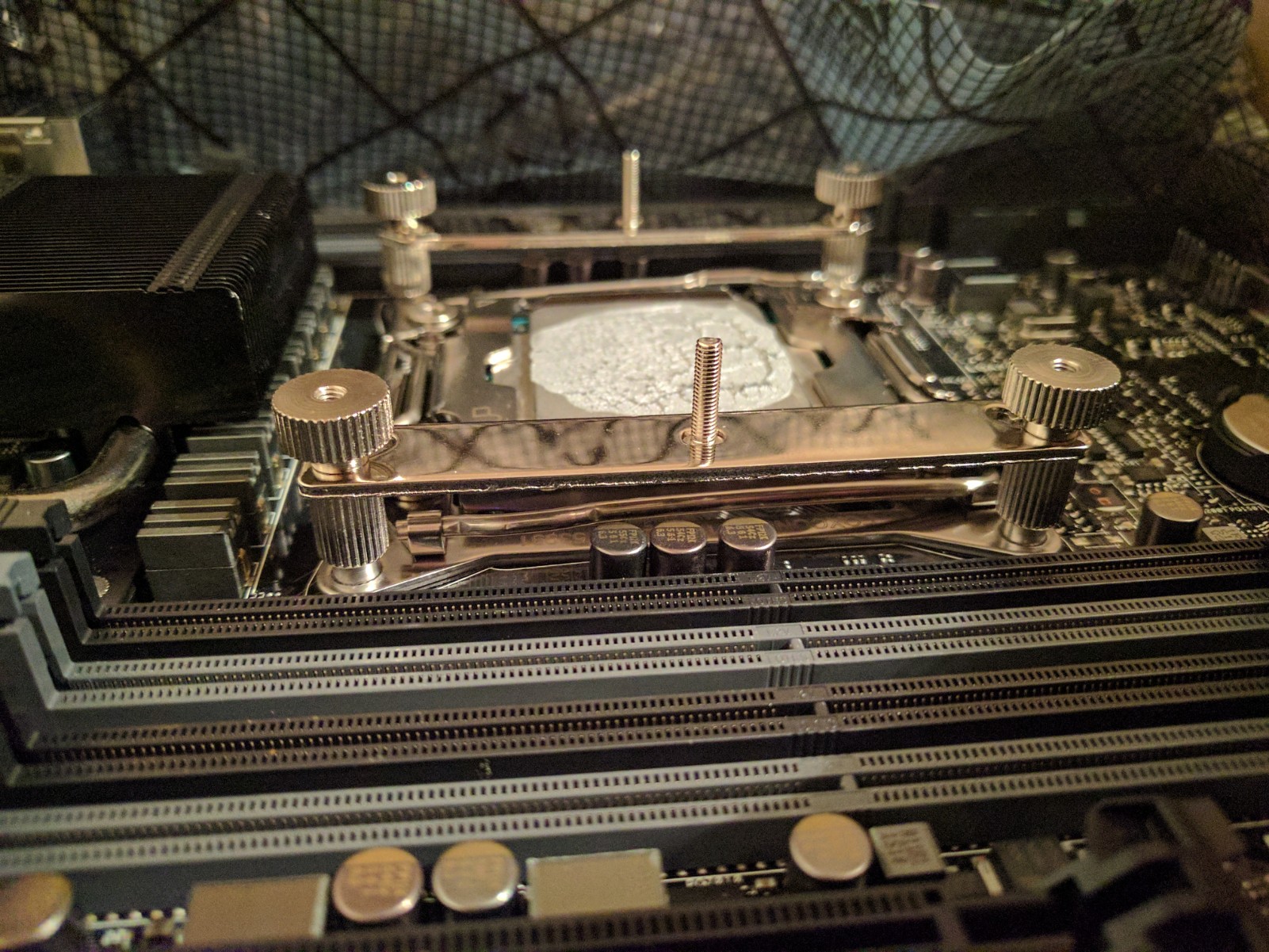

BTW, once you clamp it down, don't pick it back up. It appears that you removed it after spreading your HS compound, which leaves gaps in the compound the next time you clamp it down, as it pulls loose unevenly. Ideally you should have the correct amount of compound dead center in a ball that spreads evenly just to the edge as you clamp down. That way there are no bubbles or gaps. The less compound the better, ideally you want mirror smooth faces on both HS and CPU, so just a tiny amount of compound squeezes evenly across the face.
I'm not exactly sure I am understanding the issue completely, but would suggest clearance between the crossbars is nothing to worry about, as long as the heat plate is in full and firm contact with your CPU.  If you know the heat plate is touching, and you apply a bit of torque to ensure a solid contact to the CPU, then everything should be stable and useful.  If there's any wiggle room between CPU and heat plate, then something is definitely amiss.
Thanks both. I tightened the nuts down to finger tight - the heatsink doesn't budge.
ran the motherboard without any other components except ram for about 15 mins and temps etc seemed stable.
Perhaps you're right, and this is the intended setup - just seemed to be an awful lot of space in there.
And thanks for the tips jonathanm - first time I've ever had to remove a HS after initial setting - harder than you'd think to remove haha! (Ended up twisting & pulling)
Ideally you should clean off all the compound and do a new dot. That force to remove is caused by air pressure at 14.7 PSI, because you are breaking the vacuum seal created by the evenly spread compound. I'll bet the force to pull it loose the second time with the same compound will be less, because there will be voids and air bubbles instead of an even layer.
Thanks, I'll do that tomorrow when I build the rest of the system, thanks for the heads-up
