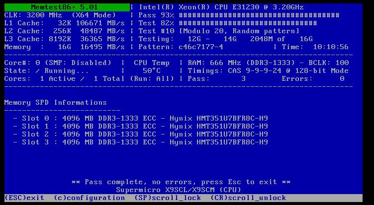

Attachments: Recent completed memory test (before moving to Unraid), the screenshot of the crash was scrolling very fast, this is from the refresh in IPMI not sure if it got anything useful though.

While your issue with what appears to be a kernel oops hasn't reappeared, its hard to tell what happened because the beginning of it scrolled off the screen (and you may not have been able to scroll it back up)
