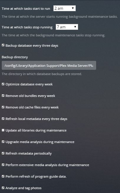

I have Plex running an an SSD cache disk, and don't notice any speed degradation on parity checks, although Plex does have some maintenance activiites that I suppose could be having a negative effect that I am not noticing:
