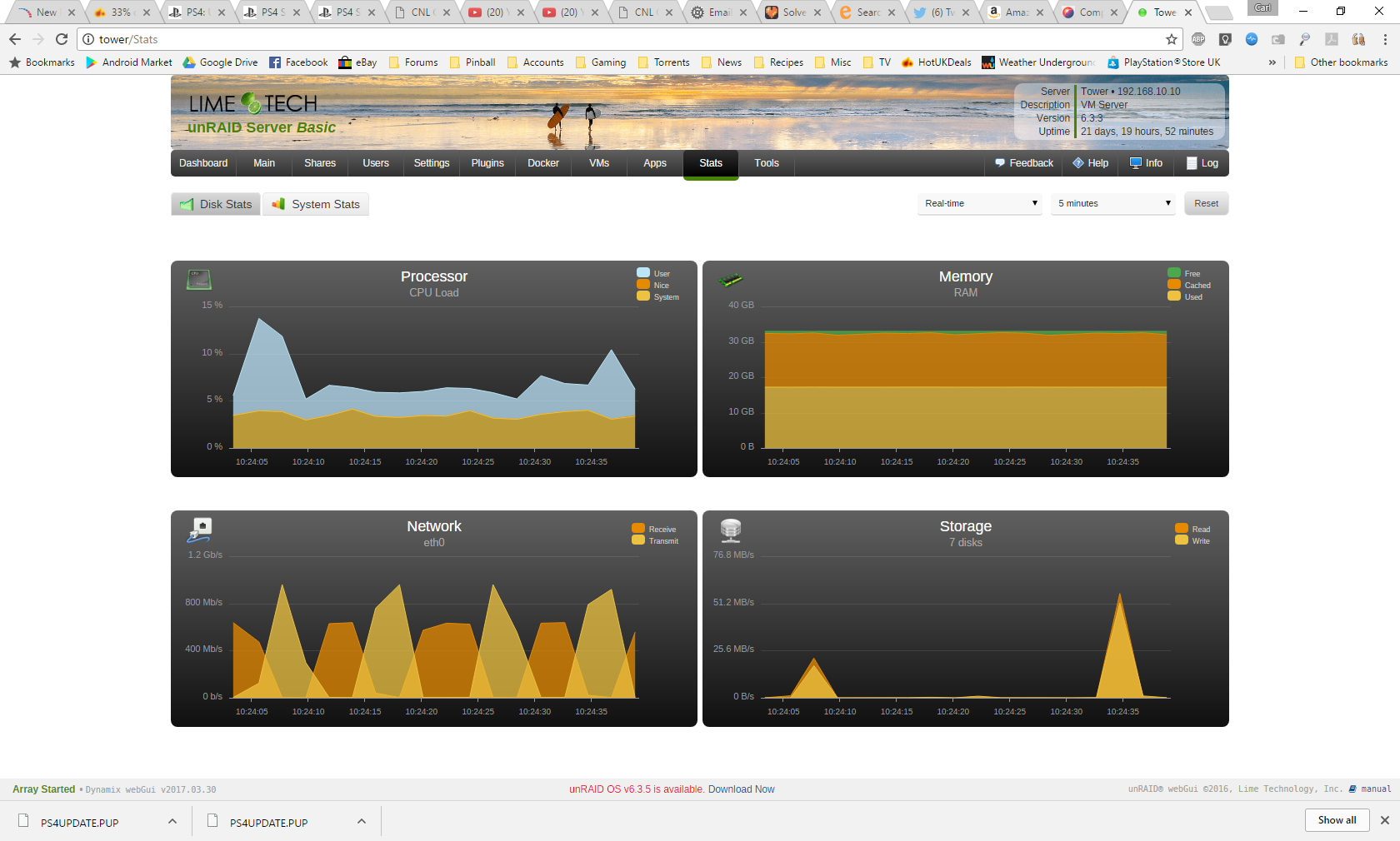

Having an issue again today with one machine writing and one reading from the unraid share, it's almost like the network isn't full duplex looking at my system stats.

The diagnostics you posted last week don't show any network issue with unRAID. Possibly a problem elsewhere with a switch or router port. Or maybe something has changed since the diagnostic. Was it working OK then?
Haven't looked at the diagnosis to see what you have (mobile) but many implementations of NICs do not properly handle full duplex and the speed will suffer

Is the only solution to try another NIC?
Looks like an Intel, which is the usual recommendation.
I think I would try to diagnose other parts of the network first. Have you tried full duplex between the other 2 machines?
